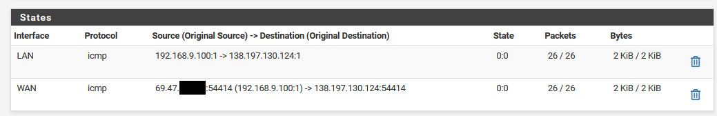

                johnpoz LAYER 8 Global Moderator @okjello
                @okjello said in Unable to ping a specific public ip when using pfsense not when bypass.:
                138.197.130.124
                This is the states you should see when pinging something on the internet

                  I see it on the wan also but its not right...
                  WAN icmp 64.66.xxx.xx:44889 (10.1.0.45:1) -> 138.197.130.124:44889 0:0 8 / 0 480 B / 0 B
                  Is it picking random port? 44889 yours shows 54414 ?
                    icmp doesn't really have a port.. But yes the way napt works is a "random" source port above 1023 will be used.
                      Yup, and that shouldn't be an issue.
