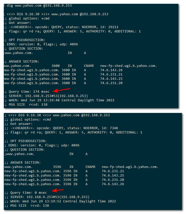

                    That has nothing to do with it.. Lets be clear on what number you were seeing? An initial query, or a query right after that.. Initial query for something that is not cached is going to be longer.. But the next query should be like zero..
                    Or maybe your NS is just overloaded? But using the forwarder, and asking for something.domain.tld is going to be cached for the length of the TTL it got back.. So you seeing 5ms is most likely your cached result?
                    Here something not in my cache
                    First resolving = 174ms, ask for it again an 0ms
                    To your cache hit value? That is all going to come down to what is being looked up, ttl values when looked up again, etc.. I am currently running at 76% cache hit.

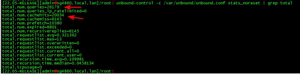

                              But that initial lookup is minor aspect of a well rounded dns setup. 174ms is less than 2 tenths of a second.. Not something to worry about, since the next query for that is going to be zero anyway, etc.
                              And those numbers can also be skewed in the fact that the resolve time having to work down from roots for something is rarely going to happen, since the gld servers will be cached as well (the ns for the tld) and then the authoritative ns for the domain as well. So if you look up say hostA.domain.tld and it has to be resolved down from roots, when you ask for hostB.domain.tld that doesn't have to happen because the authoritative NS for domain.tld is cached and the query will go direct to an authoritative NS.
                              Such benchmark tools might be ok if your trying to figure out should you ask googldns or quad9 or your your ISP dns, etc.
                              But it is of little use in running a well round resolver on your own.. Here is the thing - forward if you want.. Its your choice, but sorry the forwarder caches as well, that is not something special with the resolver.
                              I would never ever go back to forwarding - I will do my own resolving thank you very much.. I don't care if first time resolving something might take a few ms more.. Means nothing since records are cached. And I also have mine set to prefetch, and also serve 0, and also have min ttl set to 1 hour vs some of the insane 30 second and 5 min ttls being set because they like to track how long your on a site, and you have to ask every 30 seconds for it just tells them you are ;)
                              Notice the average recursion time and median in my above output- .109 and .045 those are the numbers that tell me how long it normally takes to resolve something. 1/10 of second average is not something user could ever notice.. And that is when its not cached..
