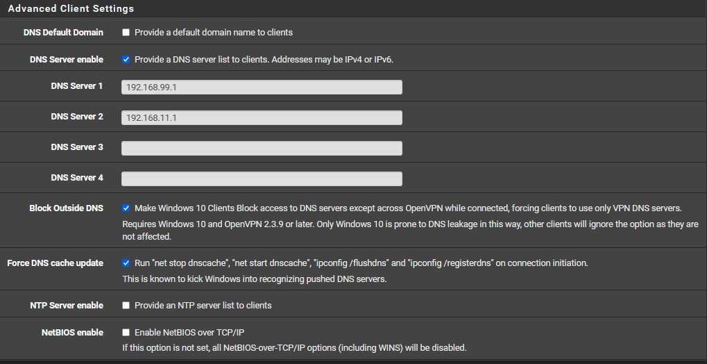

      Hi, I have OpenVPN configured and it works fine, but there is one problem. Clients connecting through it are not able to connect to local servers using their names. I don't see what the problem could be. Can you guys help?
      192.168.11.0/24 is my tunnel network
      192.168.99.0/24 is my managemet VLAN network

                  @johnpoz hmm, I have no idea why the VPN doesn't set up a server like I would need, which is 192.168.11.1.
                  When I set it that way in nslookup I get a connection timeout:
                  > server 192.168.11.1
                  Default server: 192.168.11.1
                  Address: 192.168.11.1#53

                      @johnpoz Even now I changed the server to 192.168.99.1 which is the address of the main VLAN of mine (previously I used 192.168.11.1 - the first address from the address pool for the VPN tunnel). Now nslookup was able to find the name of my local server :)
                      So the question remains what to do to make the VPN clients know that 192.168.99.1 is the DNS server...

                          dansci @johnpoz
                          @johnpoz I found somewhere on the web that it is useful to install the 'openresolv' package. This helped :)
                          Thank you for your activity on the forum and quick support on any issue :)
