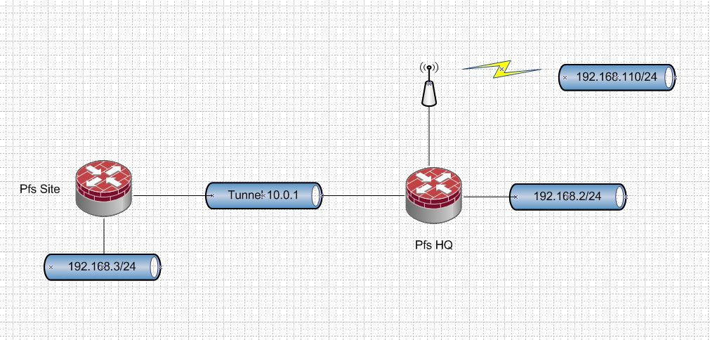

So you have this?
And your server on HQ has listed both your 192.168.2 and 192.168.110 network.
But client on 192.168.3 can not get to anything on 192.168.110 network? Can it get to pfsense IP on that network, 192.168.110.1?
Or your saying device in 192.168.110 can not get to devices on 192.168.3? Can it ping the pfsense IP on the site 192.168.3.1?
Or you say you can connect to 192.168.110 network with a wire and it works, but if wifi on 192.168.110 it does not work?
@johnpoz Yes, the network is made as you did the scheme. When I connect to wifi the dhcp gives me the 192.168.110.x network and I can ping the 192.168.2.x network but I don't pin the 192.168.3.x network, not even the site 1 network pfsense. LAN the dhcp gives me the ip 192.168.2.x and from there I can ping the network of site 1.

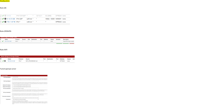

might be best to take screenshots of your firewall rules on the WIFI tab
also screenshots of your VPN-server configuration.screenshots of the routing table on both pfsense might help.

@stephenw10 here are the rules

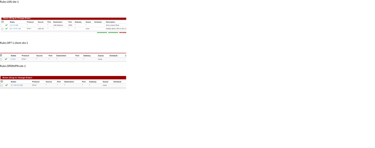

And the rules and routes at the remote site?
@miami71it this is not 192.168.110/24
So how would the site know to go back down the tunnel to get to 192.168.110? I specifically asked you this very question - and you said it was correct, clearly not from your screenshot.
