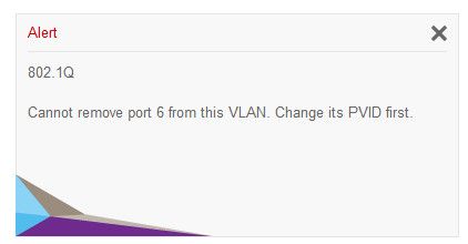

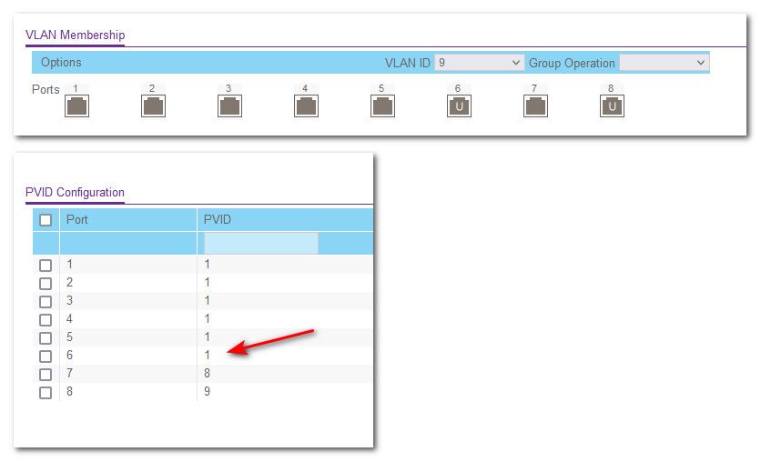

                      Example - I plugged in netgear gs108eV3 I had on the shelf testing something for another thread.
                      I put port 6 untagged into vlan 9 - it did not change the pvid.
                      Now when I tried to remove vlan 1 I did get a warning..
                      Which is good... But that it let me put port 6 untagged both in vlan 1 and vlan 6 in the the first place is bad..
                      So yeah validate the ports you put untagged in vlan X, that the pvid has also been set to X and that there is only 1 untagged vlan on the port..
