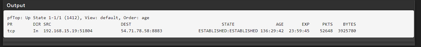

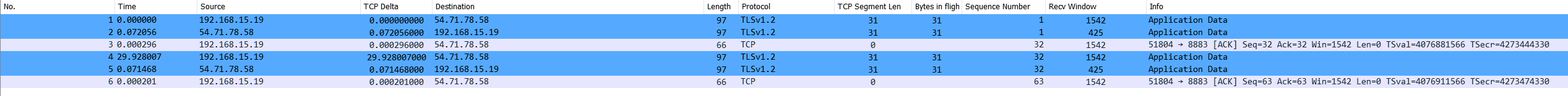

Need help understanding what im seeing here in the logs vs. pftop.Reviewing pftop, you can see the following session is active. bytes is increasing. Ran a pcap and i see tcp data bidirectionally. The problem is that destination port 8883 is not allowed.

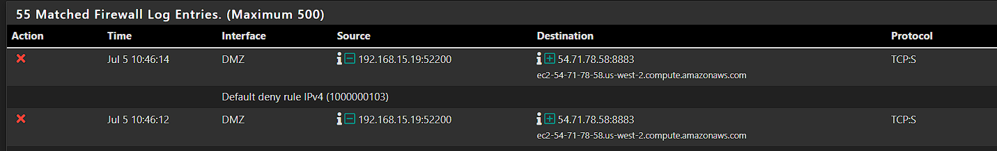

When reviewing the Firewall logs it clearly shows that its blocking. What am I missing here. This is concerning.
Here is the pcap.

@michmoor that is a different state, see the source port of 51804
While your block is source port 52200
States are looked at before rules, if there is an active state then traffic would be allowed.
Kill that state.. But until the state goes away, then yes traffic coming from that IP on that source port to that dest IP and port would be allowed. Other traffic, from different source port would be denied..

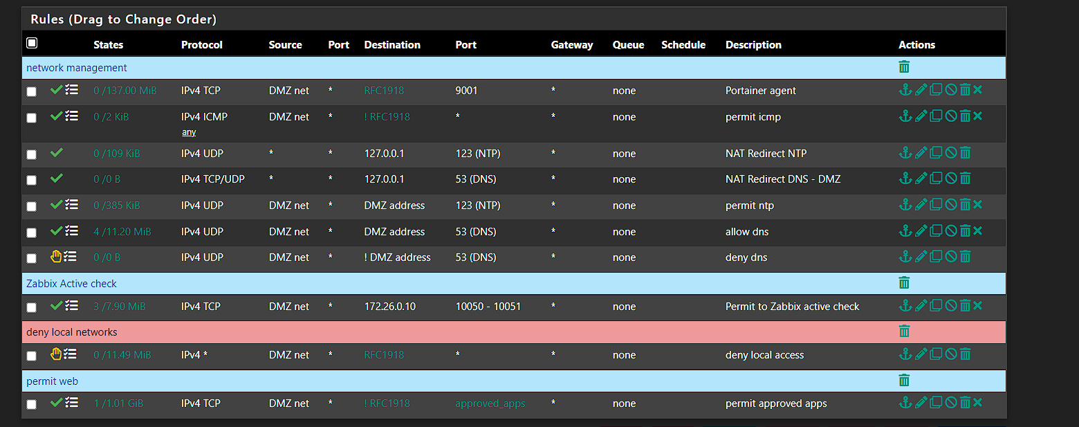

Below is my ruleset.
From this, I just don't see how that flow was active.
As I posted, 5 days ago, the only maintenance done was to reimage the firewall back to 22.05 and load my config.xml which has the rule set you see above.The only way what your suggesting makes sense is if the backup XML saves state information which wouldn't make sense.

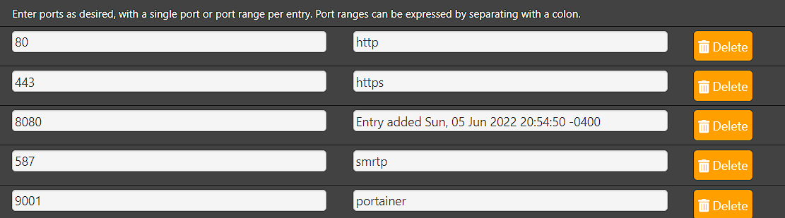

What's in the 'approved apps' alias?
Do you have floating rules? Interface groups? UPnP?
Are you still seeing states created there? You can use pfctl at the CLI to see what rule is creating them.
@stephenw10 Hey stephen,
the approved apps alias contains the following
