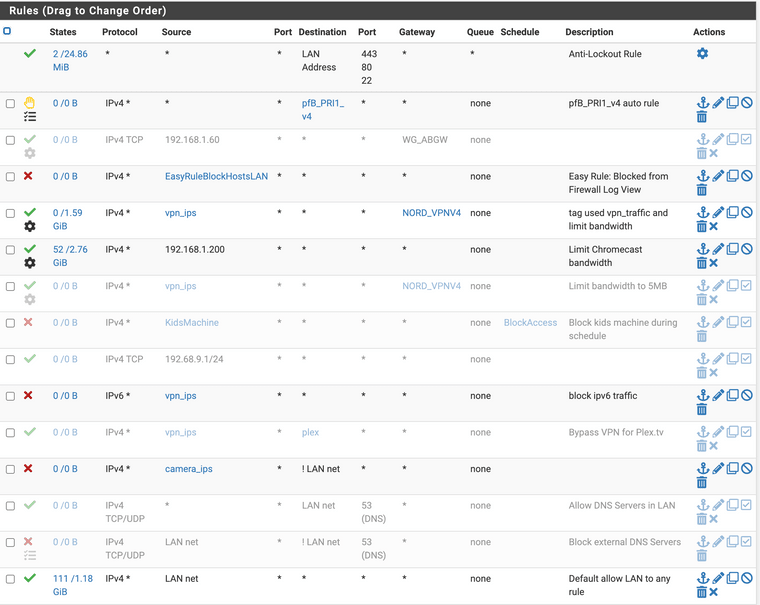

          @johnpoz NordVPN client is running pfsense ( not on the client device )Screen Shot 2022-07-05 at 12.51.53 PM.png .
          I have attached the Firewall rules for LAN. Please see the rules with source as 'vpn_ips'. vpn_ips are set to 192.168.1.50 as of now.
          • Y Offline
            yogi_en
            @johnpoz , Thanks a lot!. It woks now. I added a rule above vpn_ips as you suggested. Now I can ping. I have been struggling with issue for the last couple of days. Thanks a bunch again!

              @yogi_en yeah I would just going to ask what was in that alias where your forcing it out your vpn
              You would need a rule above that that allows those IPs to get to your other network.
              So your all sorted now?
