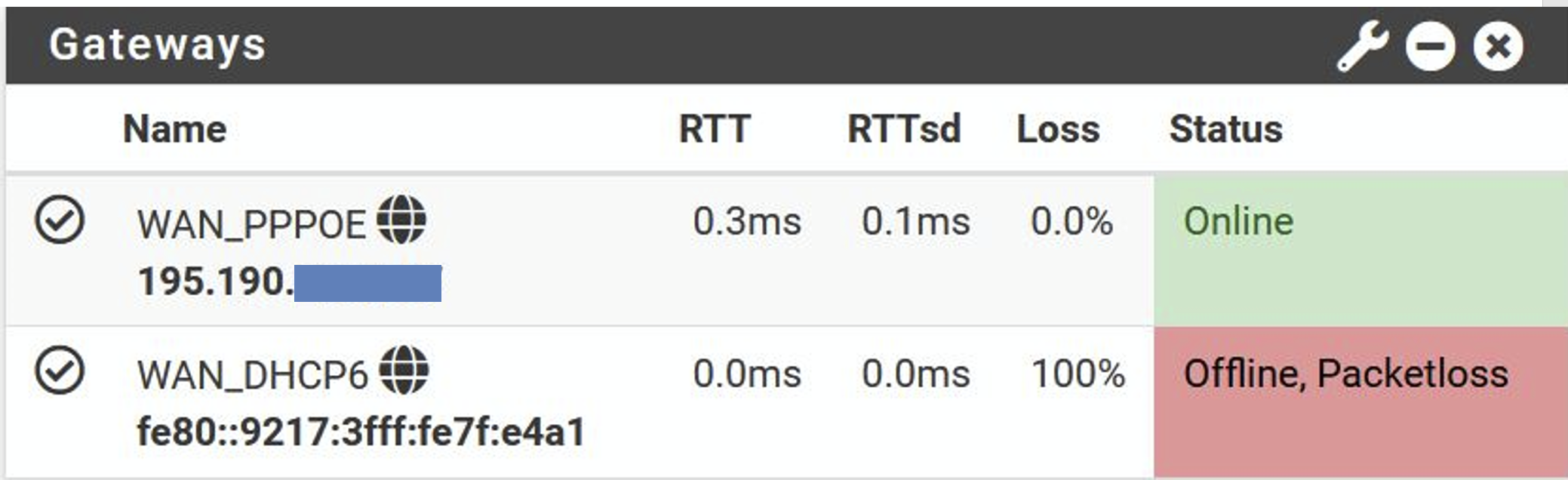

                                    Today the GUI again showed that the IPV6 was gone.
                                    To test if the IPV6 was really gone, I did ping a couple of IPV6-addresses. And ..... I could reach them
                                    Pinging 2a00:1450:400e:801::200e with 32 bytes of data:
                                    Reply from 2a00:1450:400e:801::200e: time=4ms
                                    Ping statistics for 2a00:1450:400e:801::200e:
                                    Packets: Sent = 4, Received = 4, Lost = 0 (0% loss),
                                    Approximate round trip times in milli-seconds:
                                    Minimum = 4ms, Maximum = 4ms, Average = 4ms
                                    So the conclusion seems to be that the gateway is available .... however that the GUI is not correctly updated ....

                                            [2.7.0-DEVELOPMENT][admin@pfSense.lan]/root: ps ax | grep 'dpinger'
                                            31465 - Is 0:09.22 /usr/local/bin/dpinger -S -r 0 -i WAN_PPPOE -B 77.174.abc.def -p /var/ru
                                            31795 - Is 0:07.53 /usr/local/bin/dpinger -S -r 0 -i WAN_DHCP6 -B fe80::6a05:caff:fe5a:813d
                                            88478 1 S+ 0:00.00 grep dpinger
