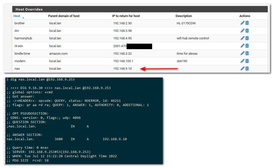

Here example some host overrides of mine.. If I ask unbound running on pfsense for nas.local.lan I get back the IP of the nas (192.168.9.10)

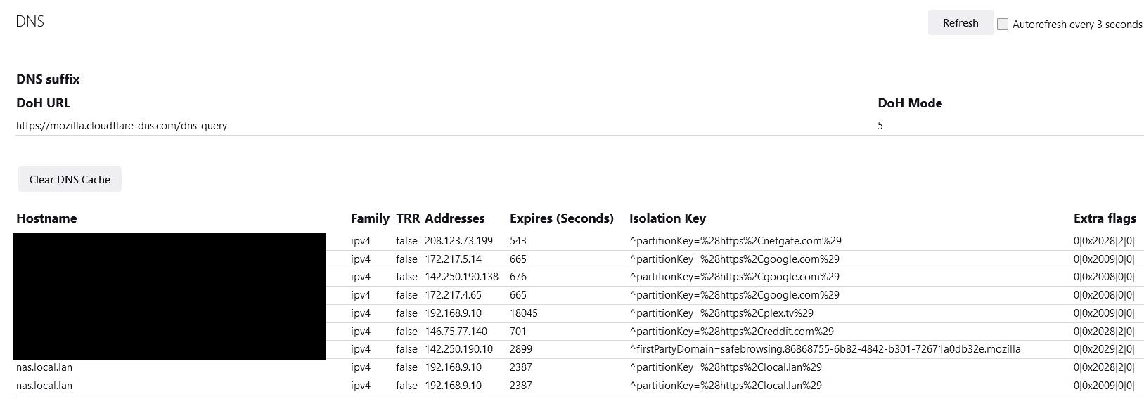

If your browser is firefox you should be able to go to
about:networking#dnsin your address bar and see what it shows for the fqdn in its cache.

These browsers and their doh ticks me off to no end.. I don't think you can view what the browser shows as IP for fqdn in chrome, but firefox you can.. And it should list your doh settings on the top
example
See my nas.local.lan - and what doh mode I am in, and if it came from TRR or not..
5 - Off by choice. This is the same as 0 but marks it as done by choice and not done by default.
