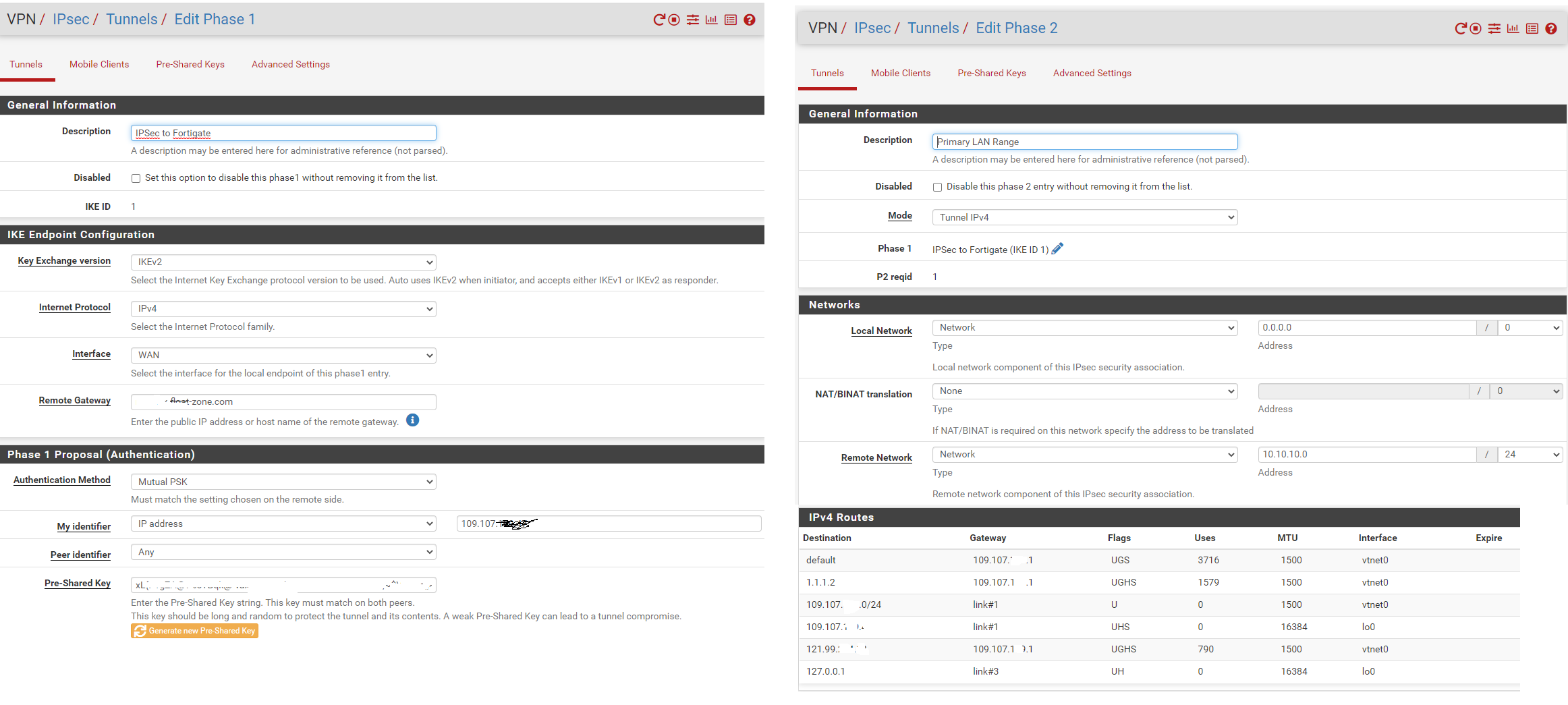

            Seems more likely to be a routing problem. When you create an IPSec tunnel it adds a static route to the end point via whatever interface the tunnel is using. You probably have a conflict of some sort there.

              nevolex @stephenw10
              @stephenw10 said in bug found: ipsec vpn ipv4 and web management do not work together:
              Thank you for your support Steve, here is my configuration.
              I am using 0.0.0.0/0 as local because Pfsense doesn't have a LAN network, as being a virtual appliance in the data centre. Essentially what I wanted to archive is to route all the traffic from my home fortigate (lan 10.10.10.0/24) via pfsense to the internet. It has been working fine, but yes, ipv4 management of the pfsense (via it's public ip address (as beeing a cloud device) is not working from my local side, but does work fine via ipv6, once ipsec runnel is down ipv4 management is working again
              Thank you for any advice

                  the issue has been fixed and was related to the routing configuration but on the Fortgate side, thanks guys!
