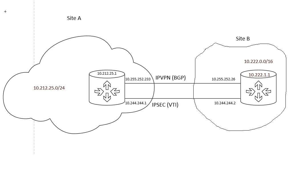

@stephenw10 hello, VTI will most likely help me, but I don’t understand how to deal with routing. Site A and site B are connected through the main channel of the IPVPN, IPSEC is a backup channel. When site A and site B are connected via IPVPN, the route from the 10.212.25.0/24 network to the 10.222.0.0/16 network will receive the BGP from the site B list prefix, the packets are transmitted, everything works. When IPVPN link goes down, traffic should be sent over IPsec link, but traffic is not transmitted, no route, when I create static route 10.222.0.0/16 gateway 10.244.244.2, traffic starts going from site A to site B. When IPVPN link goes up, traffic is still transmitted through the IPSEC channel, when IPSEC is disabled, traffic is not transmitted through the IPVPN, since I made a static route for IPSEC, I delete the static route 10.222.0.0 and only then traffic from site A to site B begins to be transmitted. I don’t understand how to use MULTIWAN and DINAMICROUTE in this scheme. Need to make a route specifically to a specific site

@stephenw10 HI, IPVPN is a service from the ISP, they let our local traffic through their routers. If I have IPVPN and IPSEC active, IPVPN works until I add routes to remote nodes through IPSEC, I add new a route and traffic stops going trough IPVPN, how much can I automatically add routes through IPSEC when IPVPN is not available?
You are using BGP to add the routes over IPSec right?
If it's always sending traffic across that then it's becoming the preferred route and you need to reduce it's preference so it's only used as backup.
How is the BGP over IPVPN setup though. Is that just between your routers or does that also include the ISPs routers centrally? That could complicate things significantly.
