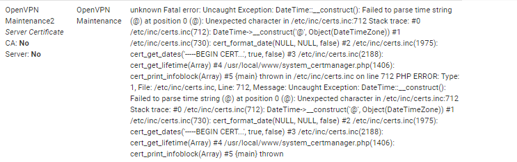

      After modify a certificate, I had a message about a fatal error with following message :
      Crash report details:
      PHP Errors:
      [26-Jul-2022 10:51:03 Europe/Paris] PHP Fatal error:  Uncaught Exception: DateTime::__construct(): Failed to parse time string (@) at position 0 (@): Unexpected character in /etc/inc/certs.inc:712
      Stack trace:
      #0 /etc/inc/certs.inc(712): DateTime->__construct('@', Object(DateTimeZone))
      #1 /etc/inc/certs.inc(730): cert_format_date(NULL, NULL, false)
      #2 /etc/inc/certs.inc(1975): cert_get_dates('-----BEGIN CERT...', true, false)
      #3 /etc/inc/certs.inc(2188): cert_get_lifetime(Array)
      #4 /usr/local/www/system_certmanager.php(1406): cert_print_infoblock(Array)
      #5 {main}
        thrown in /etc/inc/certs.inc on line 712
      Now I can't create or modify any certificate anymore. I saw a simillar topic talking about same error after 2.5.0 upgrade. My PFSense is already on 2.5.0.
      On Redmine this problem is related to Bug #11489 and changeset 29804b9e6ff07d0224d9396b063f88f486f0d231 seems to fix this bug.
      I would like to know how to apply this patch ? I juste need to copy the changeset on the right file (/etc/inc/certs.inc) ? Is there a right way to apply patch ? Does I need to restart service after that ?
      Thanks a lot.

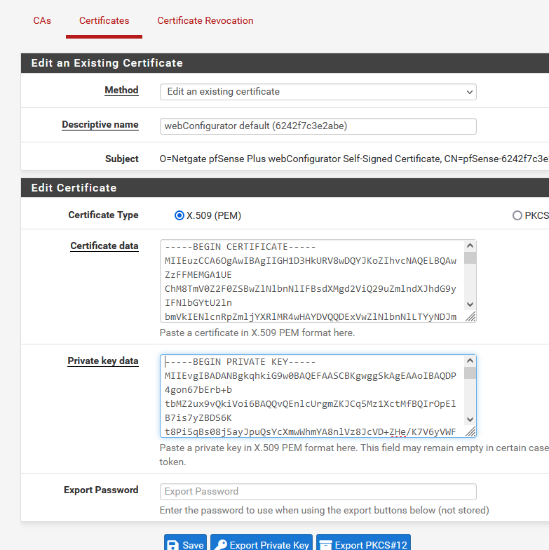

          @gertjan, It was a new cert created just few minute ago, assigned to nothing, I modified the key (it was just fort test) and save. After that the error occured and cannot do anything, see below :
          At the beginning my problem is a certificate expired, users cannot connect to OpenVPN anymore (expiration yesterday) so I tried many things like renew button but it didn't work, I had an error "error renewing certificate". So I try to create a new one and got my error after modify key ^^'
          To solve my problem of fatal error, according to you I need to upgrade to 2.6.0 ?
