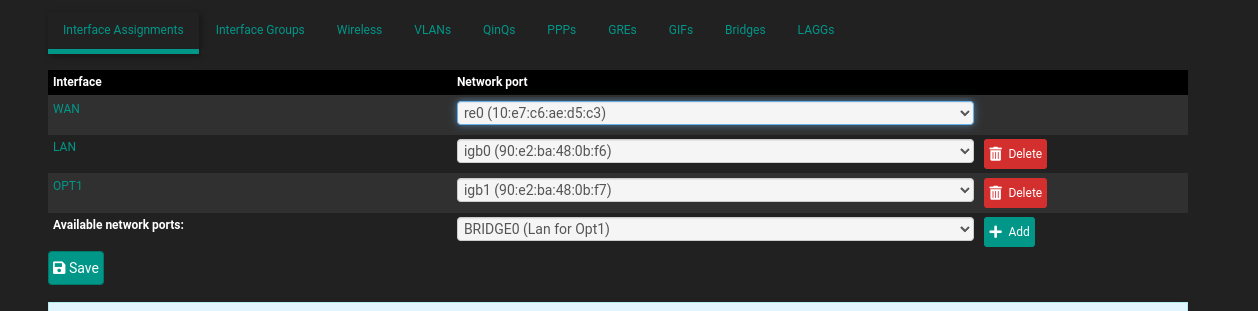

            When I said bridged interfaces I mean the screenshot below

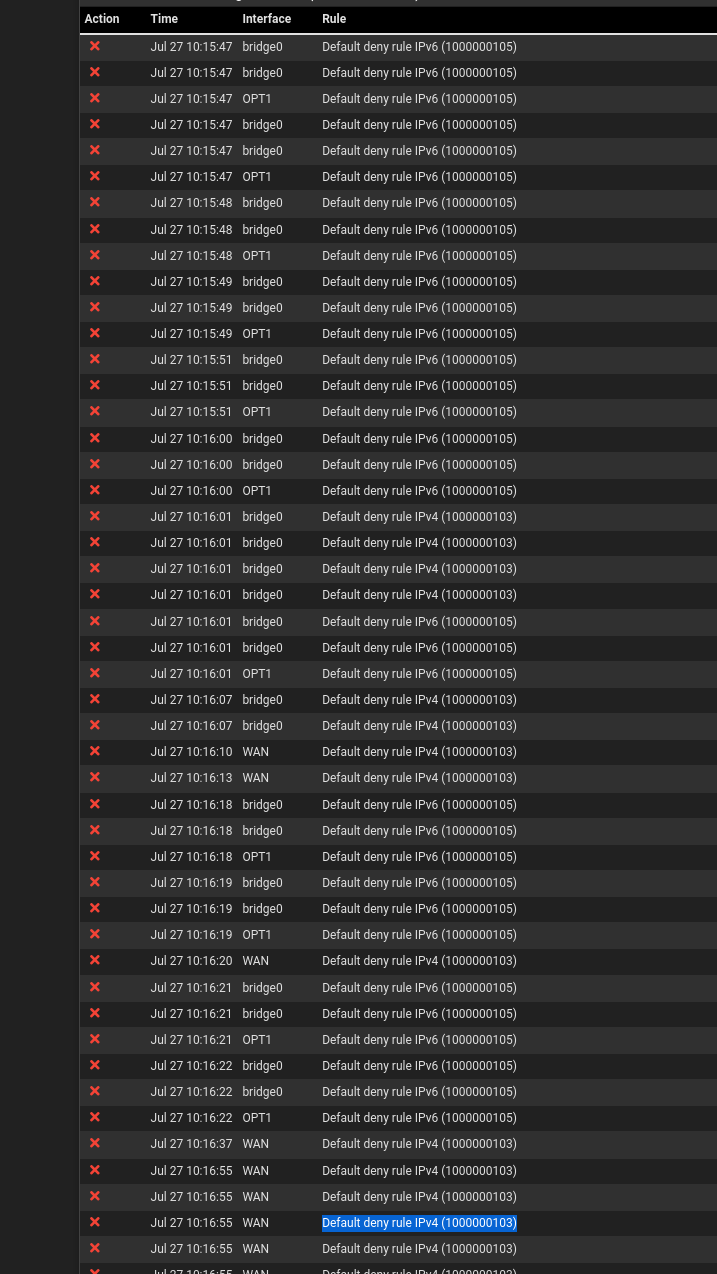

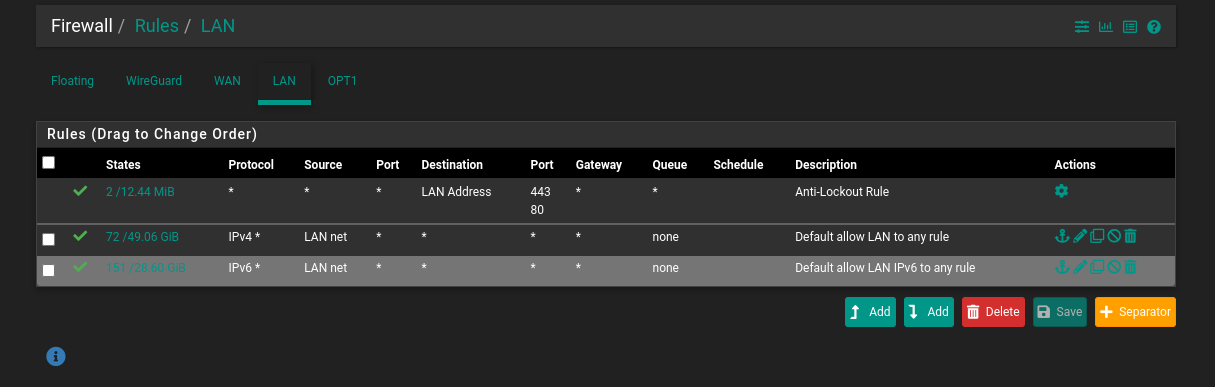

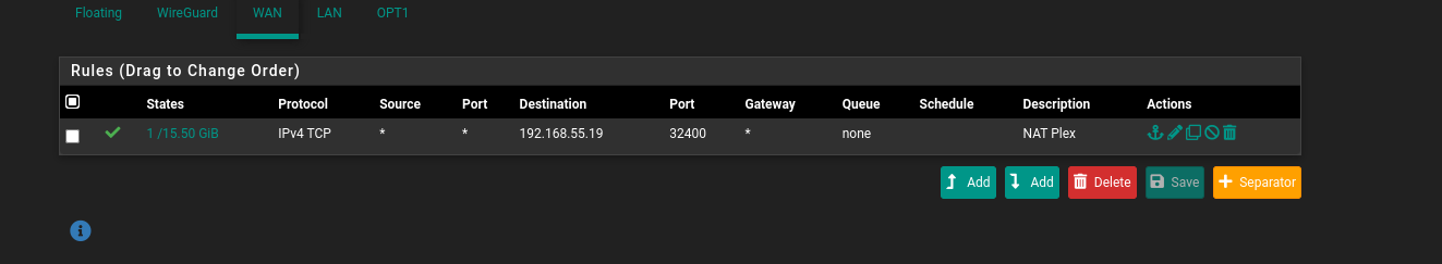

            Here is my firewall rule and Firewall logs. It looks like something is blocking but I'm not quite sure how to interpret these.

              Then: what rule is that for a WAN interface? And how are your rules for lan / opt1 interface(s)?

                Those logs all show traffic blocked by the default rule. What rules do you have on LAN and OPT?

                      The LAN interface has default pass rules but OPT will not unless you added rules.

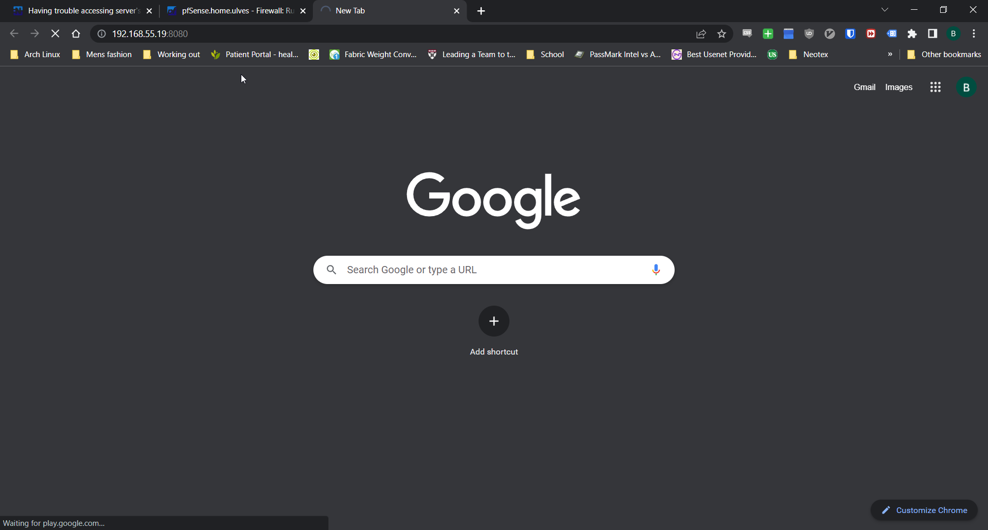

                        As for the browser it's just stuck loading like attached.

                          @garric I see in your original post that you have 3 networks - WAN, LAN, and OPT1. You also state that you have "bridged" your OPT1 and LAN ports so you can put your wireless access point on your LAN network.
                          You typically don't do that on a pfsense box, even though you are entirely able to do it. You should simplify and NOT bridge interfaces together. You can easily run your access point off of your switch, this would then automatically put it on your LAN network. I would recommend doing that first, then figure out how pfsense works - all of the ins and outs, then you can add additional OPTx networks and play with those. Figure out the basics first!

                                Your firewall logs show a bunch of default IPv6 blocks on the bridge but it's probably just local link discovery stuff. Unlikely to cause a problem.
                                Typically in the bridge for wifi to wired like that you would assign the bridge interface itself and move the filtering to the bridge and not it's members. That way you only need one set of firewall rules.
                                See: https://docs.netgate.com/pfsense/en/latest/bridges/interfaces.html#bridging-and-interfaces
                                However if you have filtering on the member interfaces, as you do now, it allows you to filter between wireless and wired devices whilst still having them in the same subnet. That can be useful in many situations.

                                Opening that connection to the server by IP address directly like that should always work if the server is actually listening.
