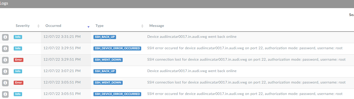

      I'm running here a bunch of SG3100 LAN-2-LAN Firewalls. Since I upgraded about 15 of my firewalls I received a huge amount of WAN Port dropouts (DHCP=new IP) for 1-2Min. every 20min up to 24h. My (DynFI) Log is quite full of these reports. Because we use NAC I had to implement the

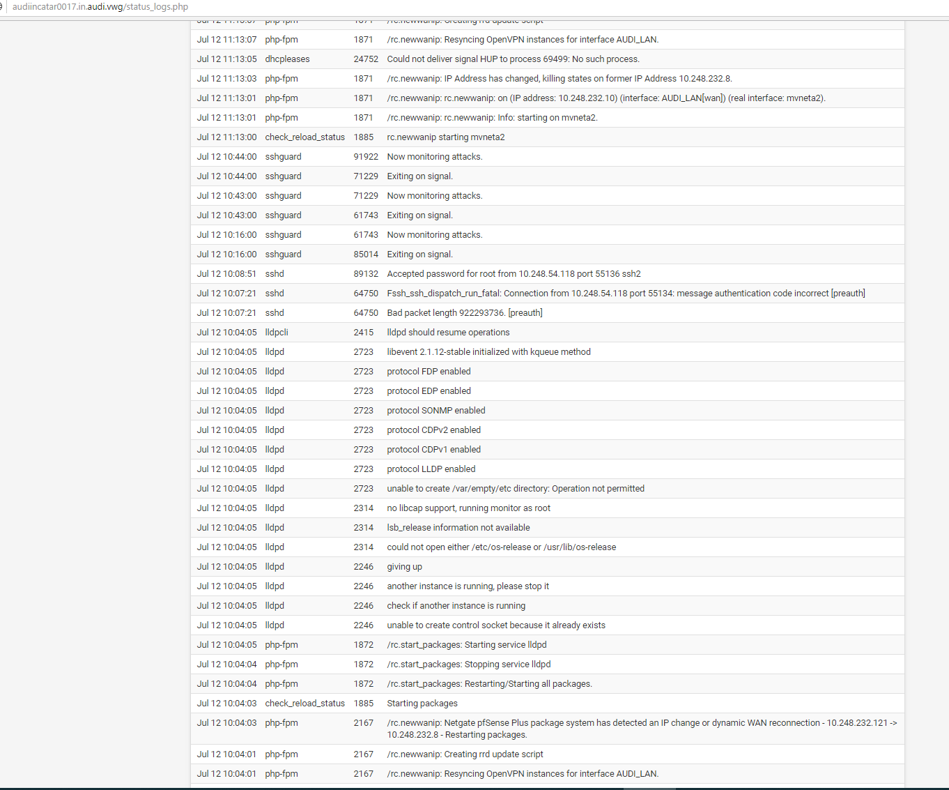

      I attached two pics of the systemlog on the client and the external DynFi Log.

        Do you know what happened at 11.13 in those logs? What triggered the new WAN IP?

          the WAN port is reported dropped, same goes for the switch log which shows the client as initiator. With the reinit of the interface the wpa_supplicant restarts (and fetch a new IP via DHCP) and everything is OK for some 30min (on some machines even up to 1 day).

            Hmm, it seems odd to me that the switch port reports the link dropped and pfSense then pulls a new IP but the pfSense logs above don't show mvneta2 losing link.

                  Unfortunately I'm unable to do such tasks as we are administrating the boxes from the "WAN" side, so when the connect brakes we have to wait the 60-120sec. until the Renew is done and connection again possible. The log shows what I see from the outside.
