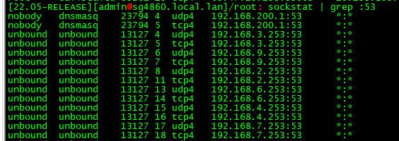

        @dirkx what version of pfsense are you using - I was able to start forwarder on one of my other interfaces that unbound is not using.
        I'm on 22.05

            johnpoz LAYER 8 Global Moderator @dirkx
            @dirkx I have vlans sure - but that interface is not... Let me setup a vlan and test it with that. But maybe you got something else duplicated, like local host? Or something?
            Here just turned off unbound on my guest vlan, nobody currently on it - and enabled forwarder on it
            edit: so guest is a vlan that forwarder is not listening on - and another vlan unbound is on, same physical interface igb2

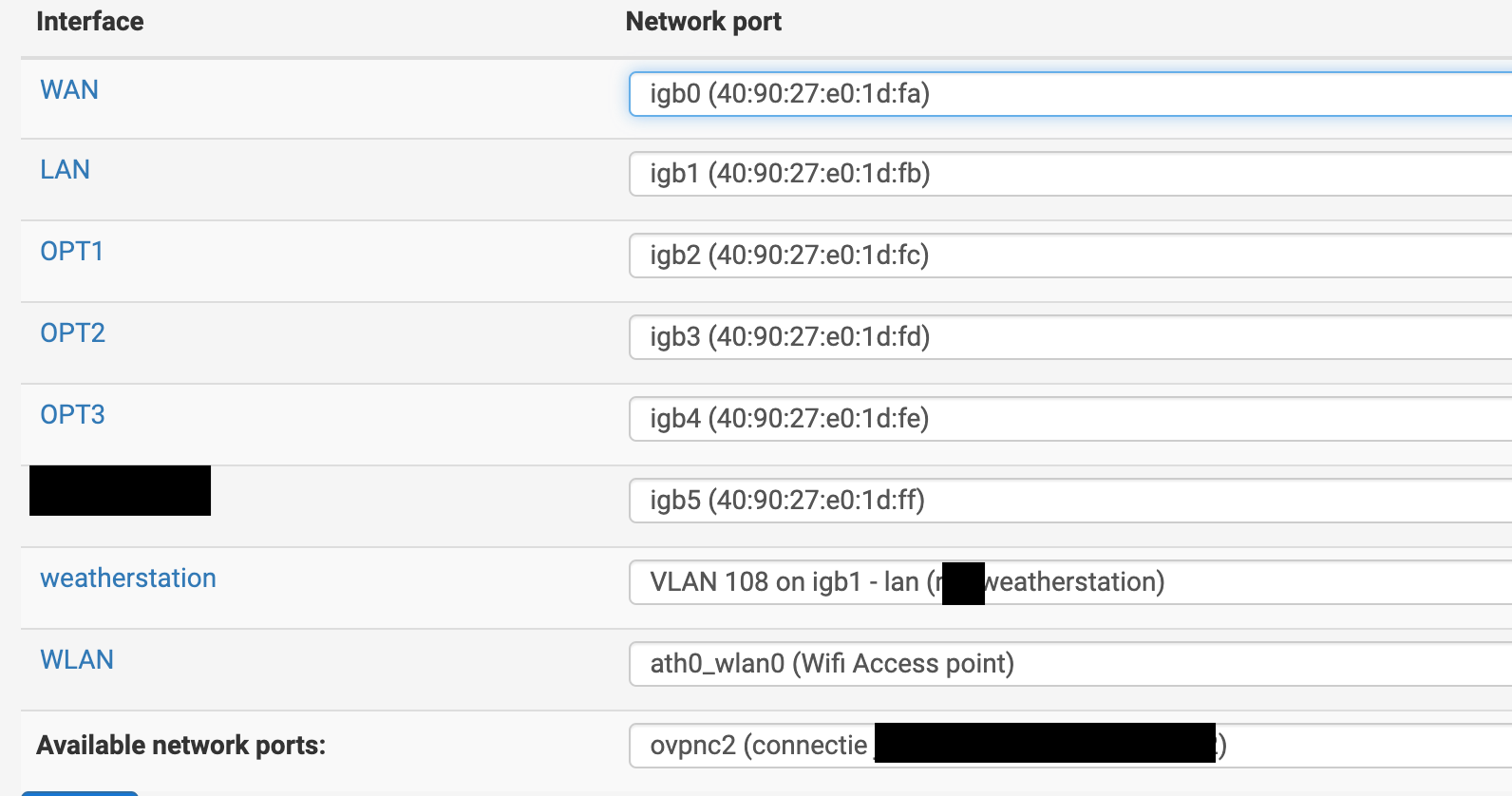

              Ok - so not sure what the difference is. Images of the config below. And I am trying to start the forwarder on just that VLAN108 which is explictly not in the list of bound interfaces of the resolver (for IPv4 and v6).
              Screenshot 2022-08-15 at 10.23.23.png Screenshot 2022-08-15 at 10.18.50.png Screenshot 2022-08-15 at 10.18.36.png

                  dirkx
                  No sorry - misunderstanding - it is bound to igb1 -- which is also a normal, non-tagged interface.
                  So on igb1 we have LAN - with a DNS resolver on 10.44.0.1/24 and try to run the wordwarder on igb1.VLAN108 on 192.168.108.1/24.
                  And it is config of the latter than the UI rejects.

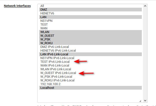

                    @dirkx
                    Forwarder states
                    "If an interface has both IPv4 and IPv6 IPs, both are used"
                    "The default behavior is to respond to queries on every available IPv4 and IPv6 address."
                    You have unbound bound to IPv6 link local..
                        @dirkx if forwarder doesn't allow you to pick not to be on IPv6, and you have unbound bound to IPv6 then yeah you have a problem.
                        I don't have unbound bound to any IPv6 addresses. On the interfaces I tested with. Nor do I have any IPv6 on those interfaces.

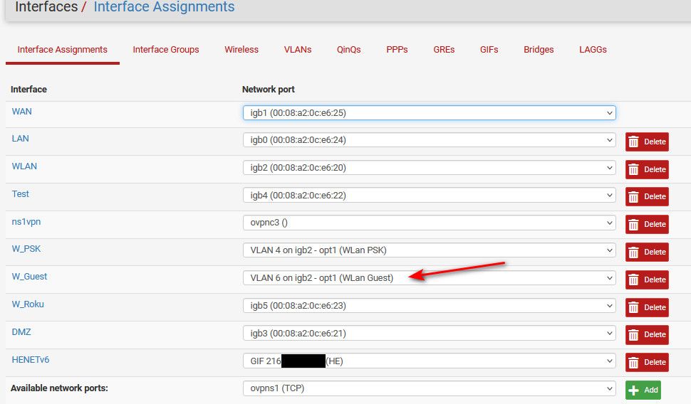

                                Hi John, On your interface assignments in post 4. You have a interface labeled ns 1 vpn. If you don't mind could you elaborate what it is for? Is it some service you subscribe to, or a remote name server you have on a VPS? I'm just curious.
                                  johnpoz LAYER 8 Global Moderator @Uglybrian
                                  @uglybrian just a vps I run - I have a client vpn connection to it that I use for testing vpn connections mostly for here, i don't have any traffic routed through it normally.
