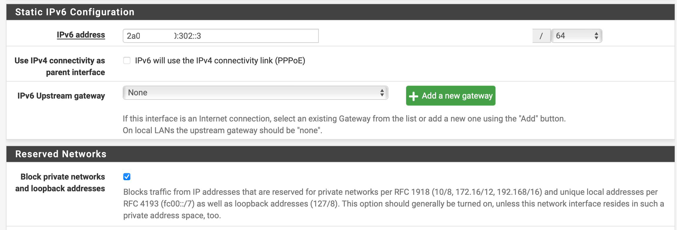

      Screenshot from interface configuration on secondary node:

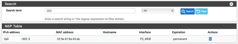

      Screenshot from Diagnostics > NDP Table on secondary node, before the configuration change:

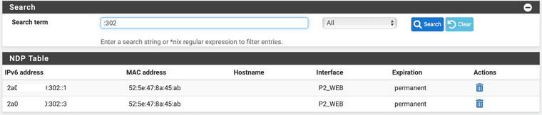

      After toggling the checkbox Block private networks and loopback addresses on the interface and applying the changes, the NDP Table looks like this:
      I don't expect to see the :302::1 address here, since this firewall is still secondary. The CARP VIP is also still listed as backup (in Status > CARP (failover)).
