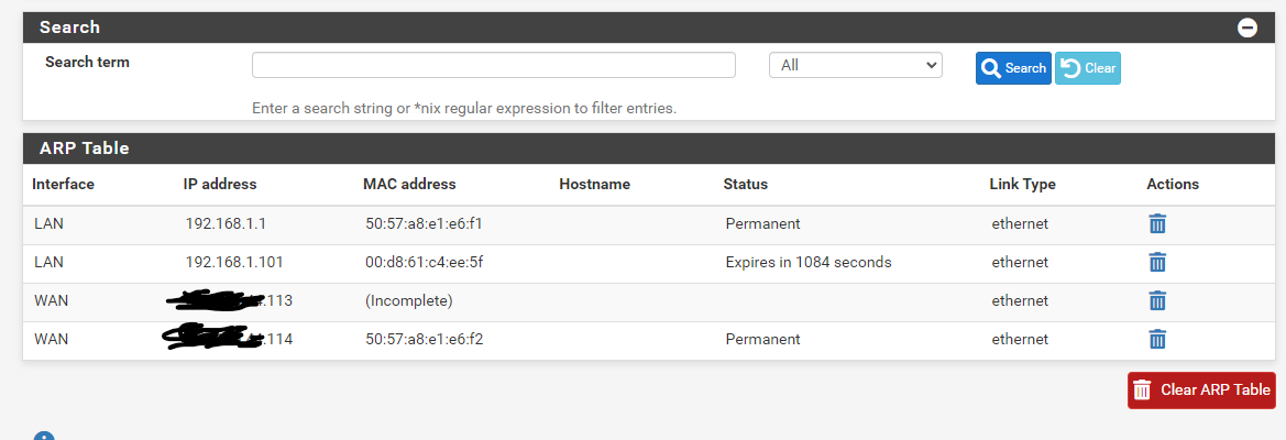

                Does the gateway appear as a complete entry in the ARP table? (Diag > ARP)

                  WECMITS @stephenw10
                  @stephenw10 said in Gateway Offline:
                  thats my arp table
                  • stephenw10S
                    Ok, it's incomplete so the firewall cannot connect to the gateway at all. It is not responding to ARP requests.
                    A layer 2 failure like that usually means something basic like a cable in the wrong port or an incorrect VLAN config in the switch maybe.
