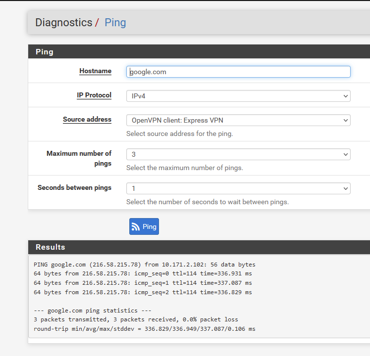

                        As said, I'm not using Nord myself, but I have a working Express ( not sure - read on ) OpenVPN client setup.
                        When I start mine, I can't really use it, as I did not complete the routing part.
                        But, I can use the active OpenVPN client interface to ping with it :
                        The 330 ms delay is due to the fact that I'm using a VPN server from "usa-sanfrancisco-ca-version-2.expressnetw.com" which is not really in my neighbourhood ;)

                        Here is one for free :
                        When you reach step 12, do the ping test first as I've shown above.
                        You will know if the tunnel is up (not usable for traffic, but up) - see my example.
