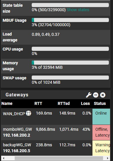

                                  Tried to access the opnsense box on the other end and the page wouldn't load. Went straight to the monitor connected to my pfSense expecting to see the screen scrolling but it wasn't.
                                  Went back to my pfSense webgui and saw the tunnel went down and was coming back up in the time it took me to get back to the interface.
                                  That was at 7am, it still is not completely back. Right now the tunnel gateway shows 1,235.1ms 174.9ms 0.0%. It was at over 5000 rtt and over 500 rttsd.
                                  So with 5 physical interfaces up, it went down but didn't crash.
                                  Could this be a wireguard bug?
                                  Gonna disable the 5th interface and see if it changes anything when I can.

                                        • stephenw10S
                                          Hmm, hard to see how the number of interfaces would affect Wireguard. It would increase the mbuf allocation.
                                          Do you see any errors on the console or logged even if it doesn't panic/reboot?
                                          Not sure if it would better to get a crash report from igb at this point. ๐Ÿ˜‰
                                          I could imagine the cxgbe driver is crashing completely but igb, when faces with the same traffic, just starts dropping it causing the massive loss/latency you are seeing.
                                          • J
                                            Jarhead @stephenw10
                                            No errors anywhere I can see but now the other WG tunnel is going out too.
