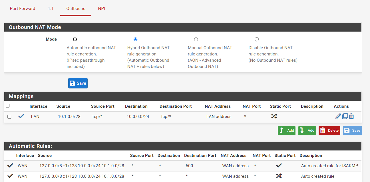

          like this ?
            johnpoz LAYER 8 Global Moderator @hendi
            @hendi yup like that should work.

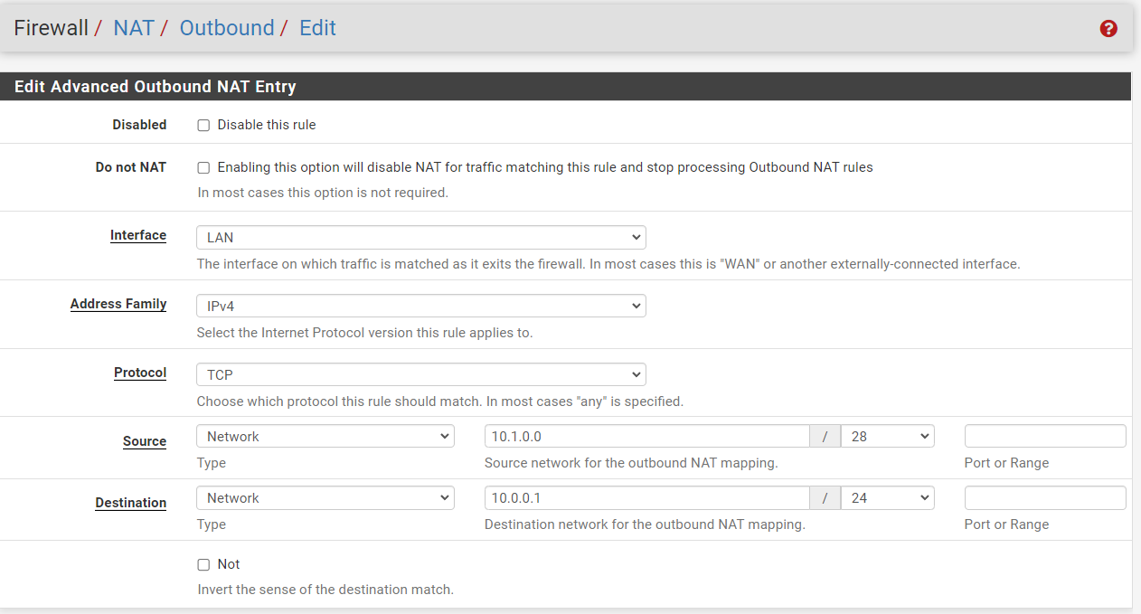

              hendi @johnpoz
              No ping from openvpn.
              Maybe it's the firewall, I'll check
              • hendiH Offline
                hendi
                After setting Outbound NAT Mode, I discovered that although I don't have ping with the routers, I can access their interface. 🙂 So it's ok. Thanks!
