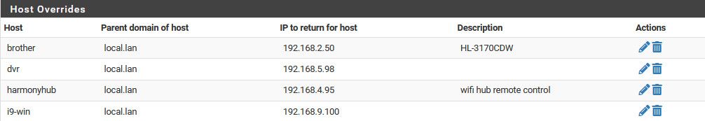

                So you have to easy methods to get server1.whatever.tld to resolve. either create a static reservation for it in the dhcp server, be it that actual client uses that reservation or not.
                Or just host override in the unbound dns section.

                    How many devices are you talking - you know you could load in either host overrides or even dhcp reservations via editing of the xml file.
                    This is normally a one and done sort of thing.. Not like something you have to change very often, only time would be normally adding a new device.
