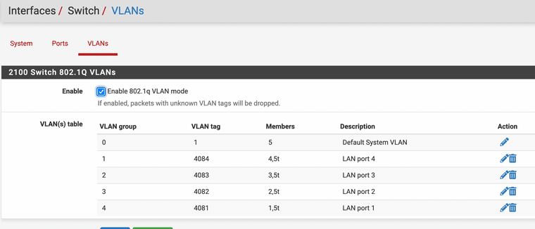

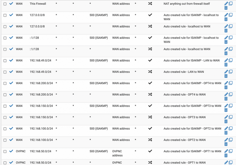

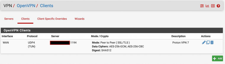

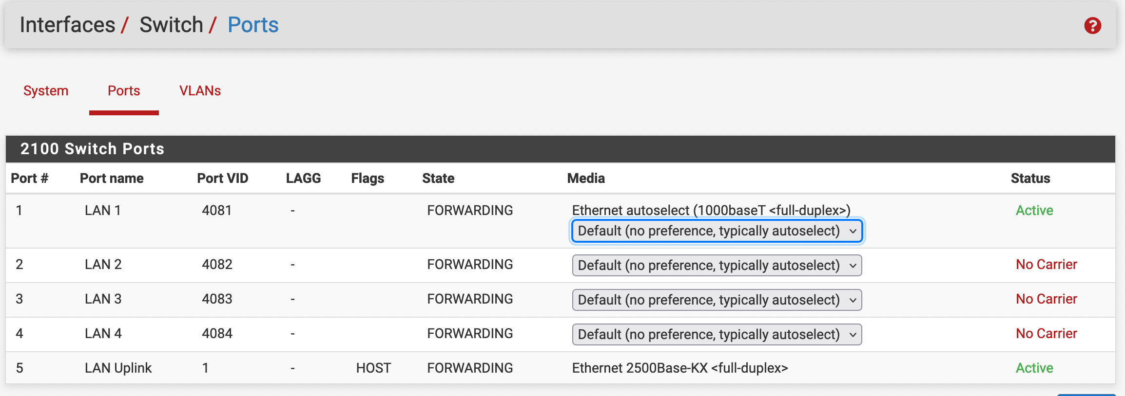

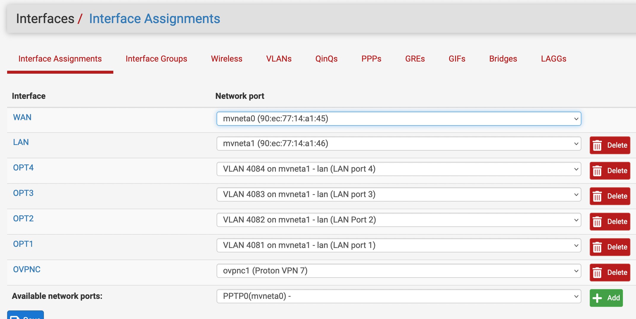

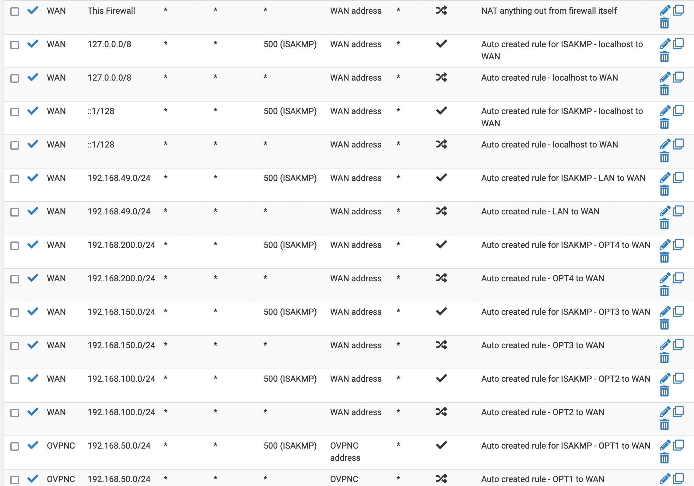

      I have a Netgate 2100 with all of the LAN ports configured as VLANs (as instructed in the Netgate 2100 guide). All ports were working just fine until I configured OpenVPN on LAN port 1/ OPT1.
      The other VLANs are getting internal IPs, but they are unable to ping out thru the firewall. I suspect there is a simple explanation, but I haven't been able to figure it out after reading the Pfsense documentation sections on VLAN, and the 2100 docs.
      Here are a few screenshots of my NAT, rules, etc. Thank you in advance for any assistance.
      dbf2b121-8a1b-4d0c-8b02-33d87c5113ca-image.png ca6b307c-fc07-4172-8743-7ffdbae94e1e-image.png

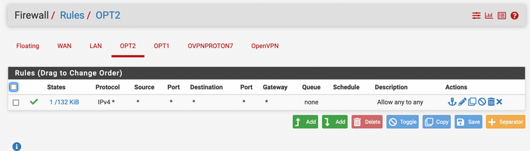

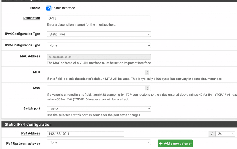

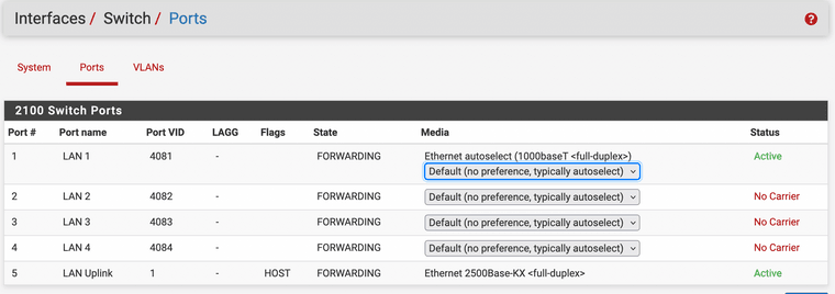

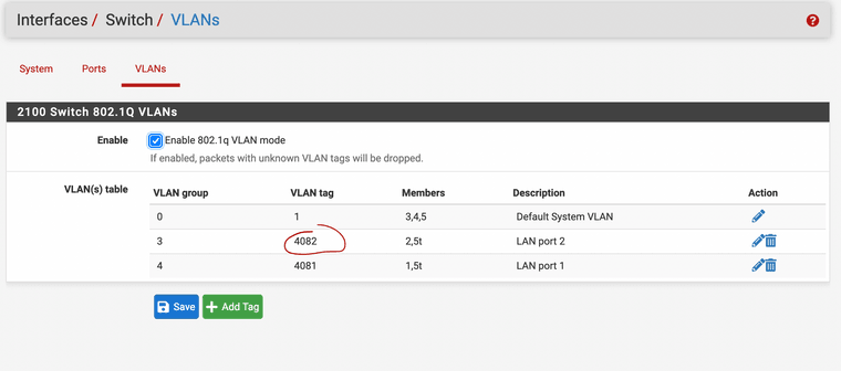

                  • P Offline
                    pourts @viragomann
                    @viragomann
                    Perhaps I should restate the question:
                    I have a VLAN defined, but it cannot reach the internet. Any ideas what I have wrong? I followed the guide in the Netgate 2100 docs.

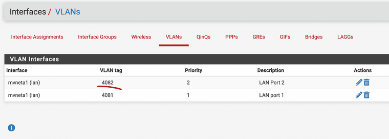

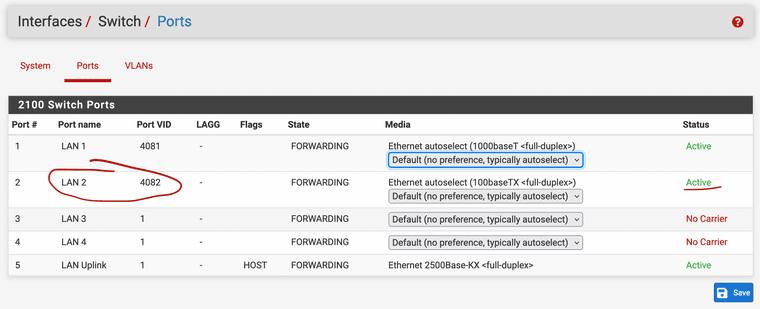

                    Assigned that VLAN to physical port #2 4fc9f9b5-ab08-4a2a-8f2c-970c80dd24bc-image.png
                    Created the VLAN interface. I have a Netgate 2100, so the only actual switches are mvneta0 (for WAN) and mvneta1 (for everything else. 32e96186-eb2e-4c8e-be87-ce112c811f2b-image.png
                    VLAN interface details: 8e9b30ee-f1c4-4075-8509-a4eb978fc637-image.png
                    Firewall rules:

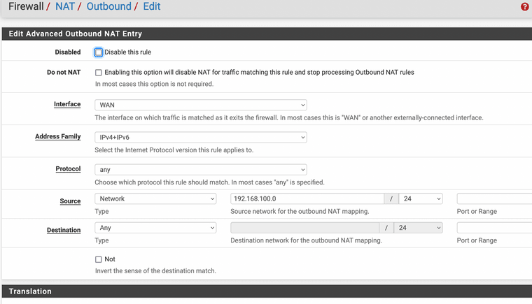

                    Outbound NAT for OPT2 (which is VLAN 4082, port #2) to WAN f14e8a54-d5f2-4318-8af4-a2f24114ee40-image.png

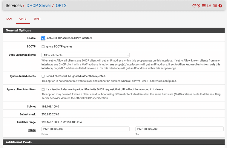

                    DHCP server looks good: 3a094946-b898-4c45-b422-5984c933061f-image.png
                    Thanks in advance!
                    • Bob.DigB Offline
                      Bob.Dig LAYER 8 @pourts
                      @pourts Don't do manual outbound NAT, use hybrid instead. What is in floating rules?
                      • P Offline
                        pourts @Bob.Dig
                        @bob-dig
                        Apologies... I was having problems with the Akismet spam filter.
                        I changed to Hybrid NAT.
                        No floating rules at all. Zero. Should I have some?

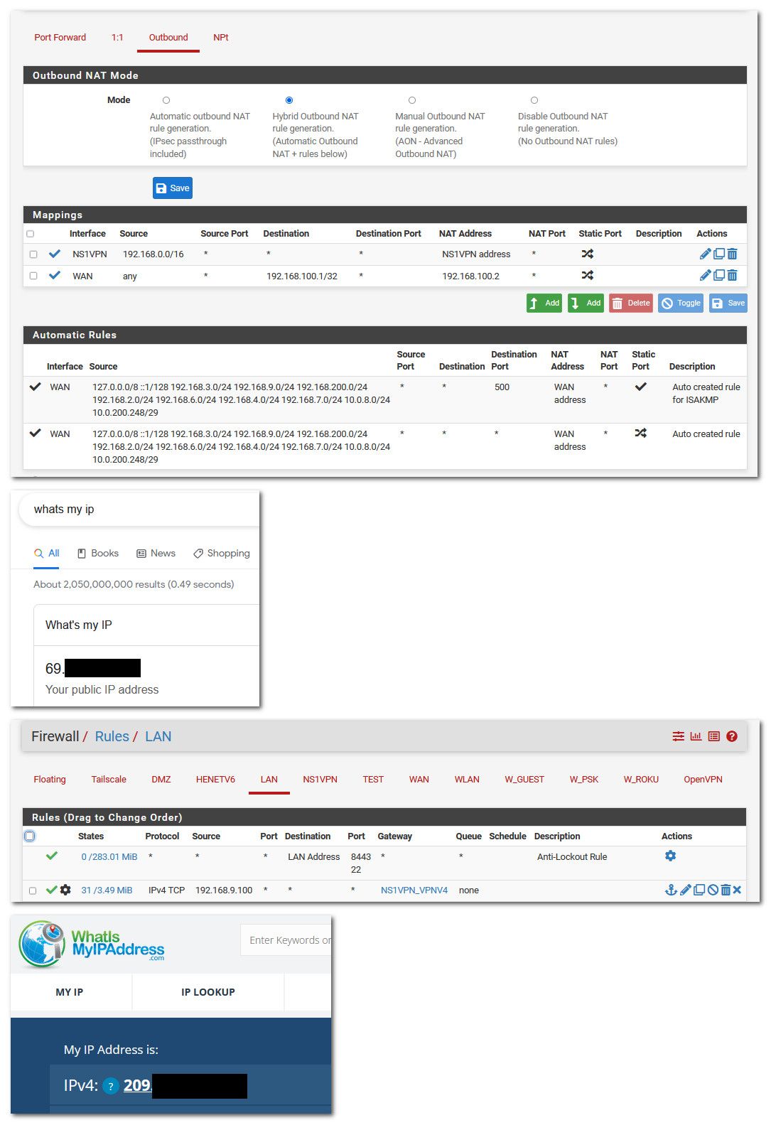

                          johnpoz LAYER 8 Global Moderator @pourts
                          @pourts if your not going to pull routes from the vpn client.. Which to be honest is better way, since now you can policy route the specific clients or sure a whole vlan out the vpn.. While your non vpn clients would just use your normal isp connection.
                          https://docs.netgate.com/pfsense/en/latest/multiwan/policy-route.html
                          And yes the hybrid outbound nat is also a better option.. This way if you add new vlans, they will auto get added, etc. All you have to worry about is your hybrid nat for clients you want to send out the vpn via your policy route.
                          edit: here you go, see hybrid nat that includes all my local networks, since they are all 192.168 address. I can then policy route anything I want out the vpn
                          So see my normal IP, then I created a policy route for my .100 pc.. Then I when somewhere new so a new state was created an it was routed out my vpn connection
                          Just going to a different site for my public IP was easier then killing my machines existing states..
                          P 1 Reply Last reply Reply Quote 1
                              @pourts said in OpenVPN Client working, but other ports & VLANs now offline:
                              because "policy routing" isn't an option in any of the GUI menus.
                              Sure it is ;) The gateway you want to send the traffic out of is policy routing ;)
                              Glad you got it sorted.
                              Hope you paid attention to the bypassing policy routing in that section, users always seem to fail to understand if you force traffic out say a vpn gateway, that it won't be able to get to your other vlans/networks that are local. So you have to have a rule above your policy route rule that allows for access you want locally.
