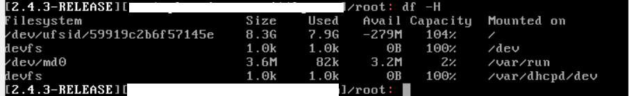

      After gaining some access via screen-sharing and getting on the console in XenCenter - we see the following:
      Perhaps a bug. Still, there were plenty of messages about "no free disk space left on X".
      First thing to check - logs. No logs were clogging up the space.
      Almost everything was being eaten by .db files.
