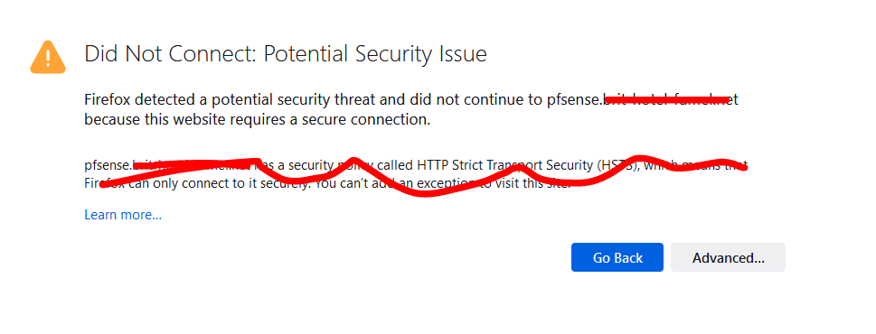

      Our PFsense box has basically gone into meltdown and i'm getting an alert every 10 seconds that the web cert is out of date. I have renewed the cert' but the issue persists, can someone advise please?

              @gertjan It uses the self signing one by pfsense. The CN has the correct ID in it however web browser says invalid certificate. Rechecked cert and expires in 12 months time so is in correct date range.
                Gertjan @Troy 0
                @troy-0 said in Renew cert' issues:
                Up to you to ask why 😊
                And then you find the reason :
                So, why waiting ? Go for that Advanced button, at the bottom, at the right.
                It's a self signed certificate.
                Signed by you. Because you made it (with some tools present on pfSense).
                And your browser doesn't know who you are - or, to be more precise, you didn't make that huge cheque to be given to author who created your browser.
                Give them a couple of $ xxx xxx xxx.00 and your browser will recognize you, and your cert will be accepted.
                Or, do what we all do :
                Now you can probably "make an exception for this site".
                And keep this in mind : the next time you re generate your Web Configurator certifciate, this error will pop up again, as your browser doesn't recognize this new, unknown, self signed cert.
