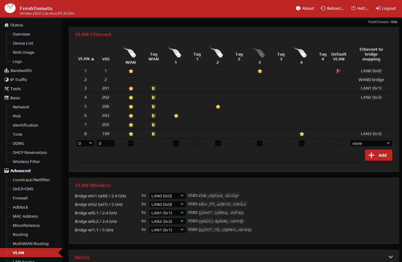

                        • Bob.DigB Offline
                          Bob.Dig LAYER 8
                          My old and beloved Asus Router is doing it here and still going strong...
