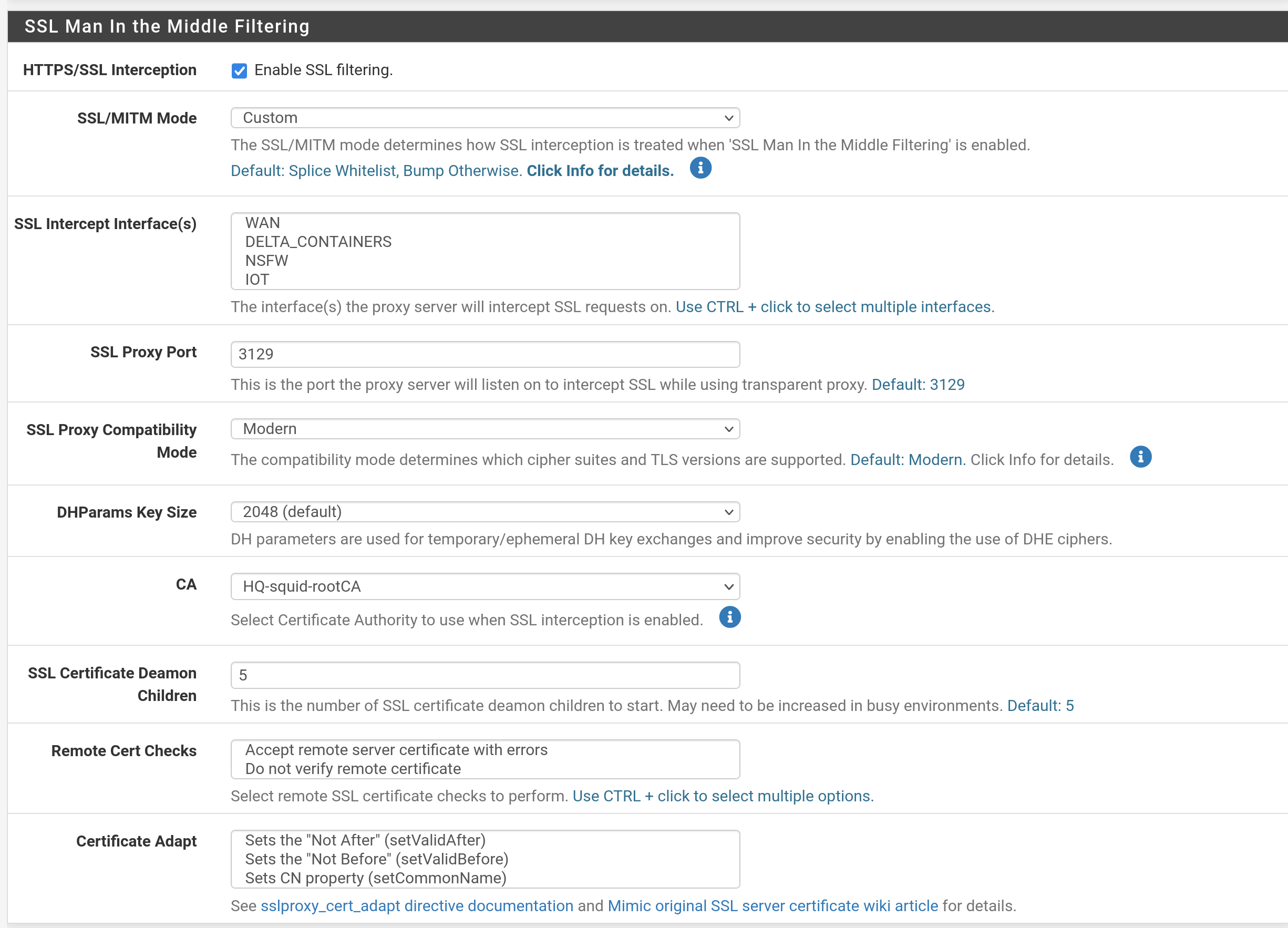

        Update: Increasing the bounty to $20. Also, here's a block of squid.conf that is close to the solution. I'm losing my mind, all the search engine queries have turned purple.
        acl srv1 src 10.1.1.1
        acl srv2 src 10.1.1.2
        acl srv3 src 10.1.1.3
        acl srv4 src 10.1.1.4
        acl hv1 src 10.2.1.1
        acl hv2 src  10.2.1.2
        acl lb1 src 10.3.1.1
        # ACLS
        acl debian-repos dstdomain "/usr/local/etc/squid/hq-whitelist/debian-repos"
        http_access allow debian-repos srv1
        http_access allow debian-repos srv2
        http_access allow debian-repos srv3
        http_access allow debian-repos srv4
        # Hypervisors
        acl xcp-repos dstdomain "/usr/local/etc/squid/hq-whitelist/xcp-repos"
        http_access allow xcp-repos hv1
        http_access allow xcp-repos hv2
        # Load Balancers
        acl load-balancers dstdomain "/usr/local/etc/squid/hq-whitelist/load-balancer"
        http_access allow load-balancers lb1
        Anyways, I keep getting ERR_ACCESS_DENIED and have added this block in Custom Options (SSL/MITM) - and selected Custom for SSL/MITM Mode.

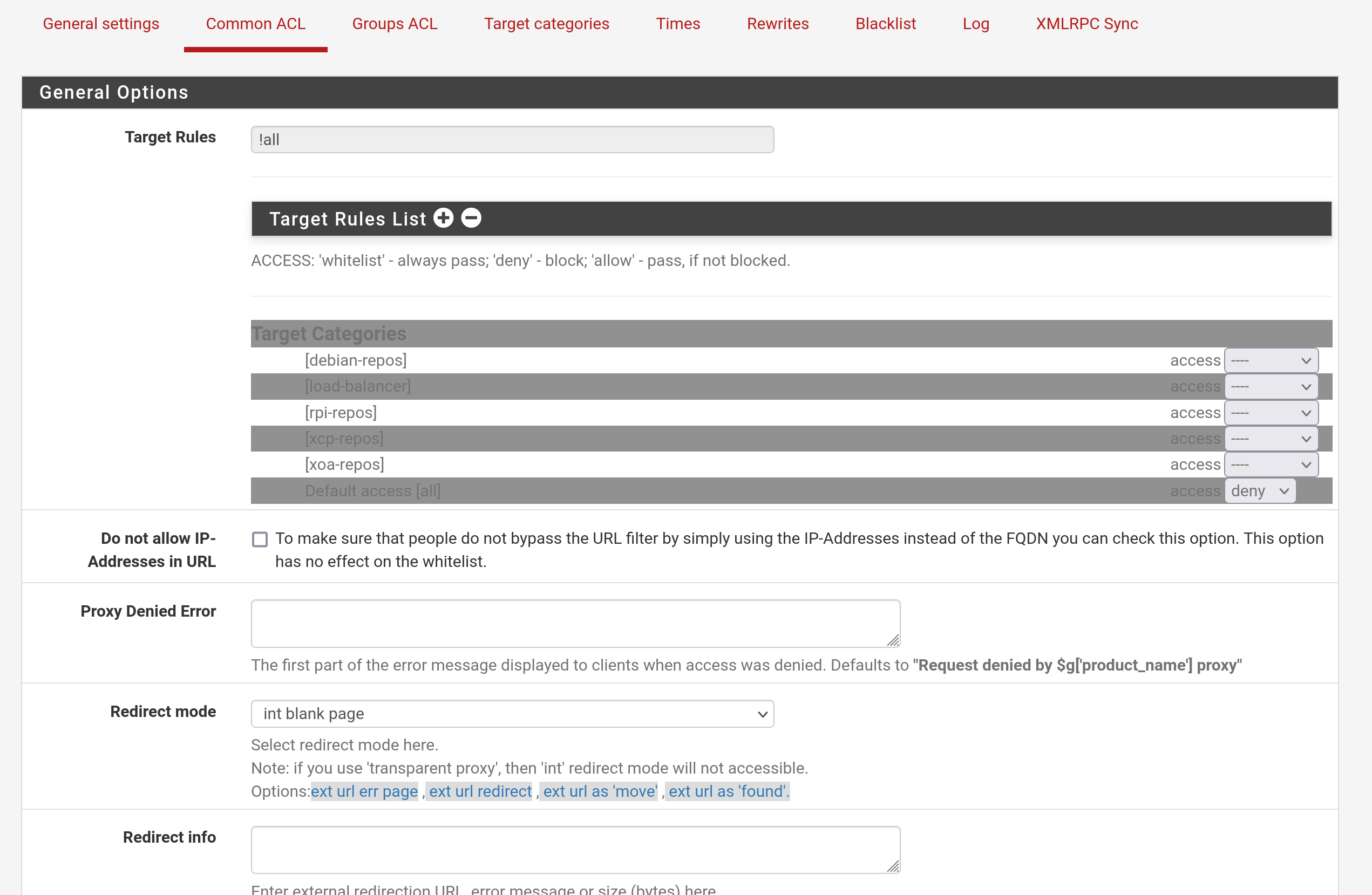

            @foolcoconut Squidguard does that with ease. Squid is just a cache. if you want URL filtering then squidguard is required.
            • F Offline
              FoolCoconut @KOM
              No joy, I've been looking into it for the past 2 hours.
              The bounty is still on, if you have an idea how to make this work you win.
              I can't seem to make a whitelist in SquidGuard either, it's either all or nothing, which makes absolutely no sense.

                My config:
                • F Offline
                  FoolCoconut @FoolCoconut
                  Squid works properly by itself without squidguard, relevant config:
                  Custom Options (SSL/MITM):
                  # some source IPs that should not be MITM-ed
                  acl splice_only src 10.2.3.4
                  acl splice_only src 10.3.4.5
                  acl splice_only src 10.4.5.6
                  ssl_bump peek step1
                  ssl_bump splice splice_only
                  ssl_bump bump all
                  KOMK 1 Reply Last reply Reply Quote 0

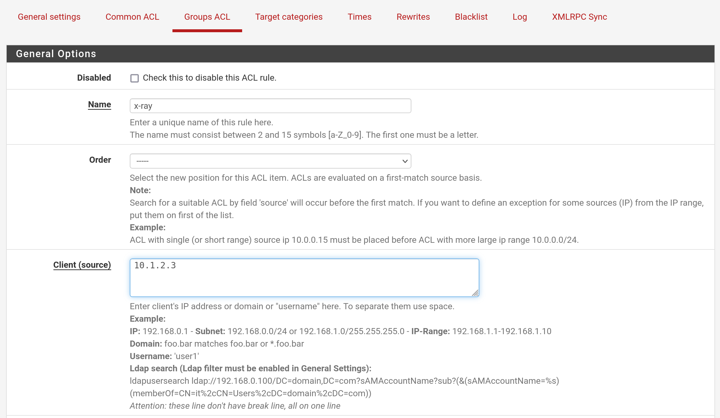

                    @foolcoconut You create your groups via Squidguard - Group ACLs. For each group, you edit the Target Rules List to determine where they can go. For you, you would only need a simple whitelist and then block all else.
                    • F Offline
                      FoolCoconut @KOM
                      @kom Exactly what I posted in the screenshots above, a single whitelist/allow (neither work) for a target group, and deny everything else.
                      • KOMK Offline
                        KOM @FoolCoconut
                        @foolcoconut When you make changes to squidguard , are you going back to the General Settings tab, clicking Save and then Apply? You have to apply your changes or nothing works and I've seen many people get burned by this.
                        • F Offline
                          FoolCoconut @KOM
                          @kom Of course, that's why I've been doing this for 3 days 8 hours daily. Because every time both squid and squidguard need about 3 mintues to fully restart.

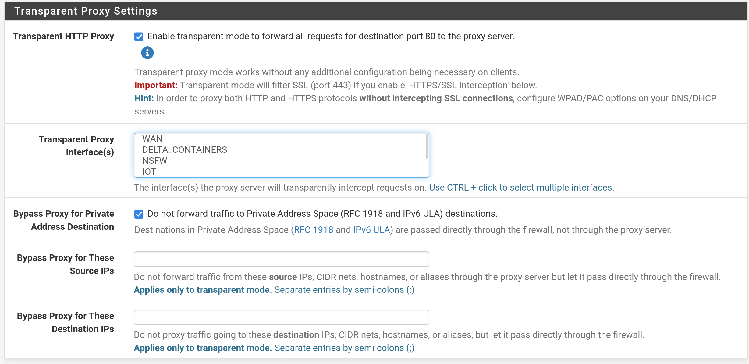

                                  @kom Well, you didn't technically solve my problem, but you did help lead me in the correct path. I'll send you a DM to further discuss the delivery of a small appreciation token, for your time spent.
                                  As a solution, I've implemented SG rules per host and disabled the transparent proxy option in squid, apparently that was causing issues. Everything now works as it would make sense, otherwise I would have literally lost my mind troubleshooting and trying the same thing in 15 different ways over and over.

                                    @foolcoconut Transparent mode seems more convenient but I've found it to be a major pain in the ass. I use explicit mode along with WPAD to help clients find the proxy, and DHCP option 252.
                                    Don't forget to add a block rule on LAN for tcp80,443 to force clients to use the proxy. I also created an exemption list and allow any IPs on that list to go direct.

                                      @kom My use case was to restrict internet access to internal servers, allowing only permitted URL/IP combos, distro repos, etc. So no need for WPAD (+ I have no idea how it works)
                                      And yes good of you to mention it because I forgot, also blocked all internet access in pfsense rules.
