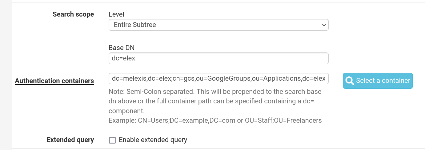

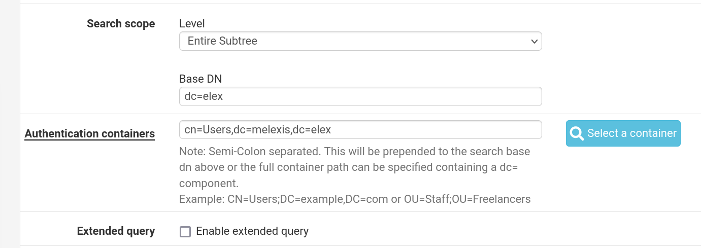

            Ah, OK. How have you configured that in the GUI?
            • G Offline
              Glaring @stephenw10
                Hmm I expect that to be entered in the extended query options if you need it:
                https://docs.netgate.com/pfsense/en/latest/usermanager/ldap.html?highlight=extended query
