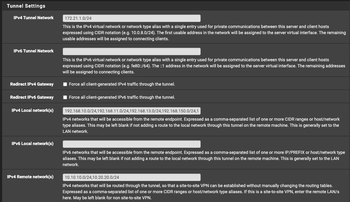

      Server settings at HQ:
      Server settings site A

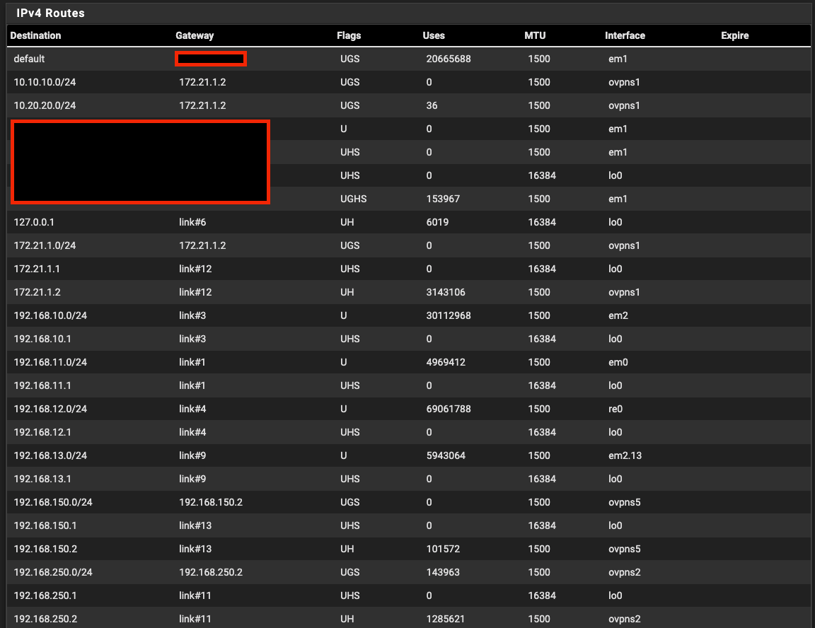

      Routes at HQ, OVPN server. Notice how the route for 10.20.20.0/24 has the IP address of the remote site OpenVPN client in the OpenVPN tunnel network listed (172.21.1.2):
      Routes at HQ server

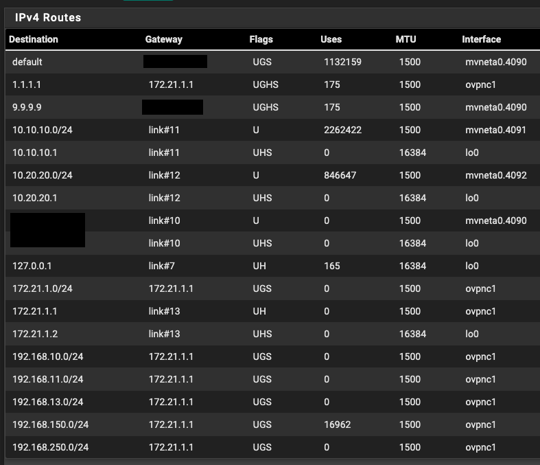

      Routes at remote site, OVPN client:

        First, it's a peer to peer, you need to use a /30 or /31 as tunnel. Otherwise you need client specific overrides, so the tunnel is relevant actually.
        Second, you have no settings on the client side.
        Fill in the tunnel, and remote networks.
        OpenVPN sets routes for you by those settings.

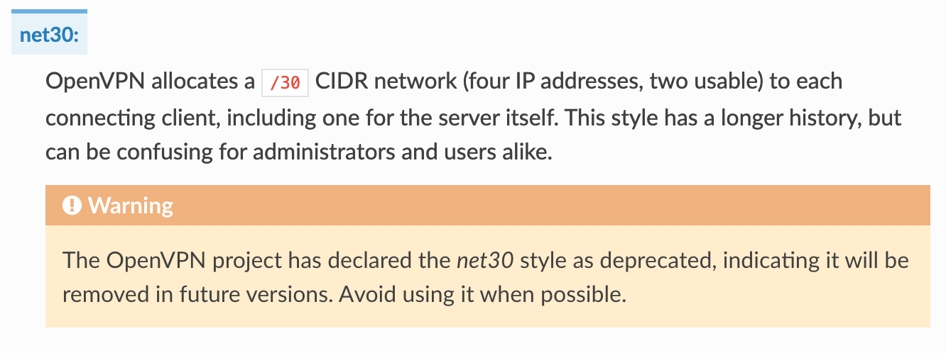

            Note: I did not use the "net30" topology option, as this will be deprecated, according to pfSense:

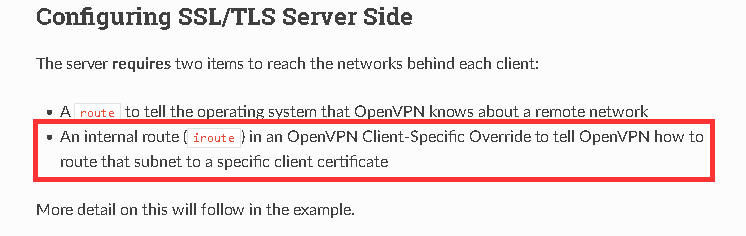

              @aviatorpaal said in Peer to Peer routing unidirectionally:
              Netgate docs, in their configuration example unfortunately uses a /24 as the tunnel network, which led to the confusion:
              You should read the whole document:
