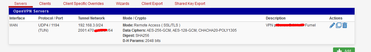

        So, when I have this on the OpenVPN server settings page :
        I know that my tunnel IP network is
        192.168.3.0/24.
        OpenVPN server will use the dot 1
        My first openvpn client will have .2 etc - and again, it's not a DHCP server that gave this IP. You don't even set up a DHCP server that works for the 192.168.0/24 network !
