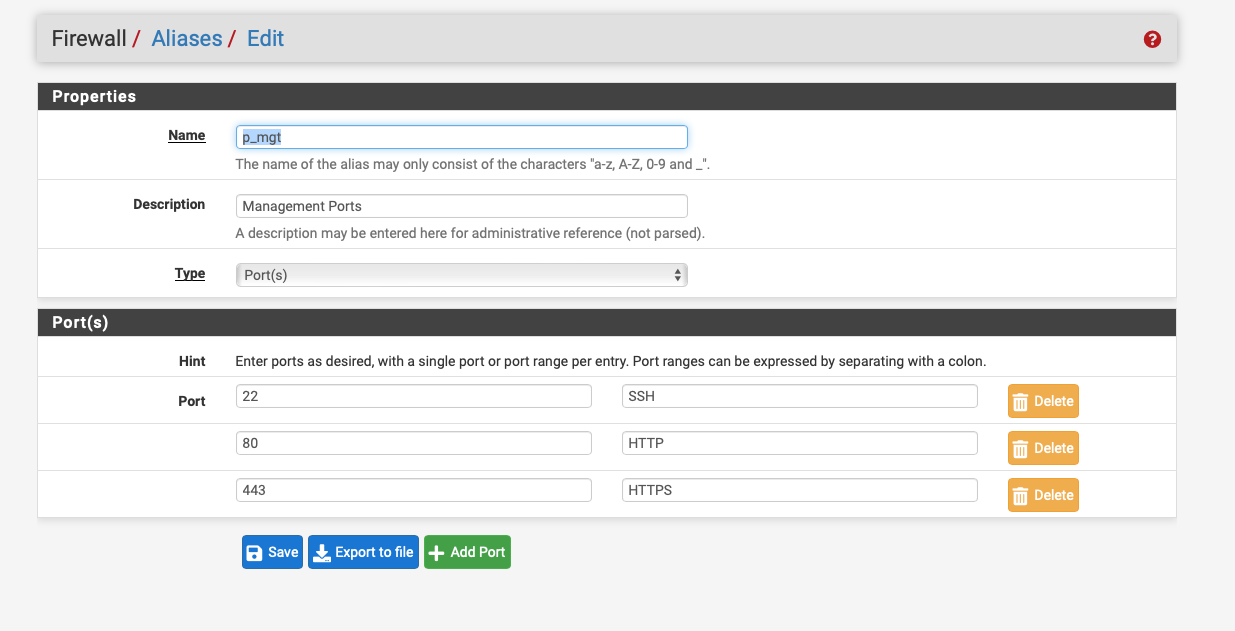

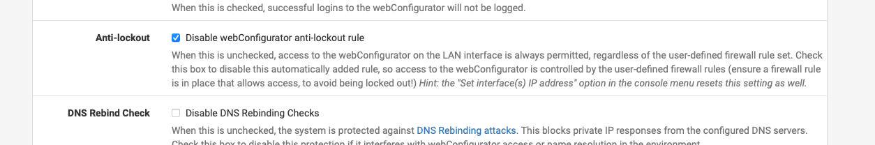

        @terry-c Disable it via System-> Advanced - > Admin if you have to, its not doing any harm if you leave it.

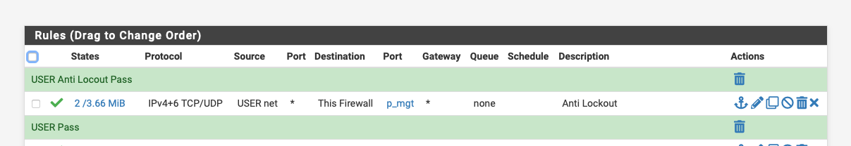

        Then create a new rule.

          You can't move it dircetly. It's always applied to the first internal interface.
          As shown above though you can disable it if you're sure you won't be locked out.
