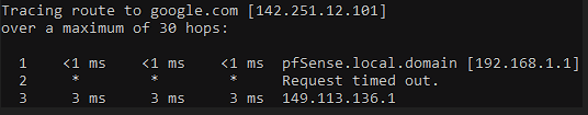

                mltobing
                @viragomann My current setup like picture below
                  rcoleman-netgate Netgate @mltobing
                  @mltobing So... remove OpenWRT and plug the Laptop into the LAN port. Does the issue resolve? Then it's OpenWRT, not pfSense.
                  Ryan
                  Wireless: Aruba, Ubiquiti
                    mltobing
                    @rcoleman-netgate I tried that already. Same result
                    This is the trace route from my laptop connected directly to pfSense LAN NIC.
                    I cannot see 192.168.10.x (This should be pfSense not OpenWRT)

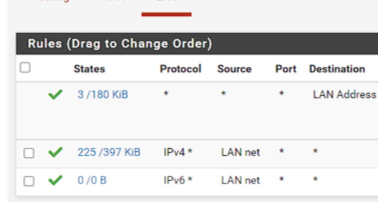

                        @mltobing said in Able to ping, nslookup and curl in pfSense box but curl failed in clients:
                        I also think need to add rule(s) to allow the traffic but I don't know which rule and what kind of NAT configuration I need for this. Any idea what rules and NAT configuration I need for this ?
                        On the LAN interface all traffic is passed by default unless you remove that rule or block the traffic.
                        AHA!
                        The default rule says LAN NET for the source... I suspect 31.0/24 is being blocked because it is not 1.0/24
                        change that to Any source (did you change this?) and it should be good to go.
                        Ryan

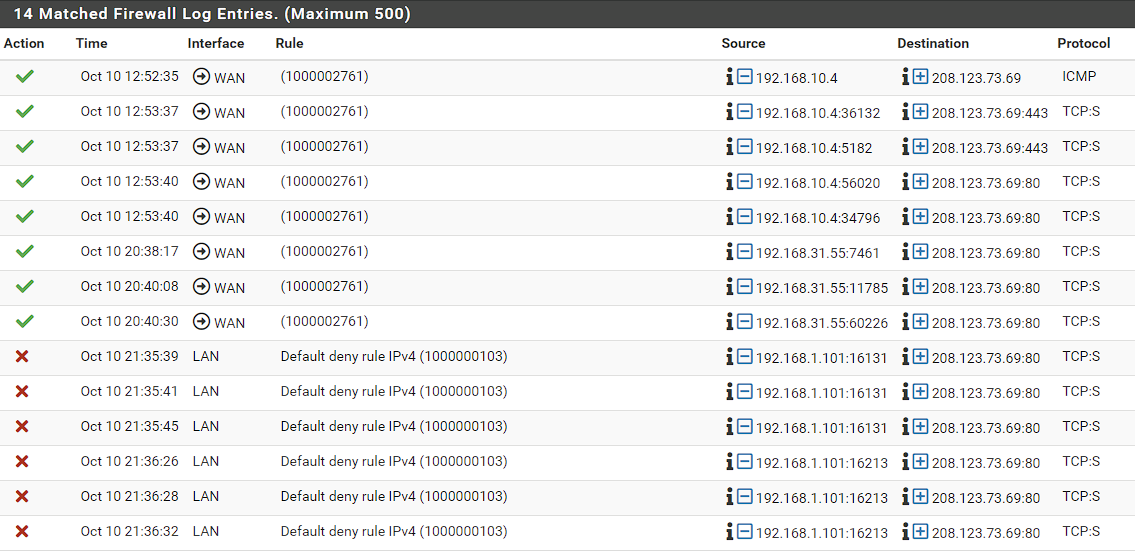

                          mltobing
                          @rcoleman-netgate When you mentioned something wrong with OpenWRT, I removed OpenWRT and my laptop connected directly to pfSense LAN NIC so my laptop using 192.168.1.x.
                          I followed your instruction to update LAN Net to any. But still same.
                          From Firewall logs I found only ICMPv6 blocked (because I just disabled IPv6) and then the first record because I tracerouted from WAN to LAN IP Address. There is no other traffic blocked. Please check this picture.

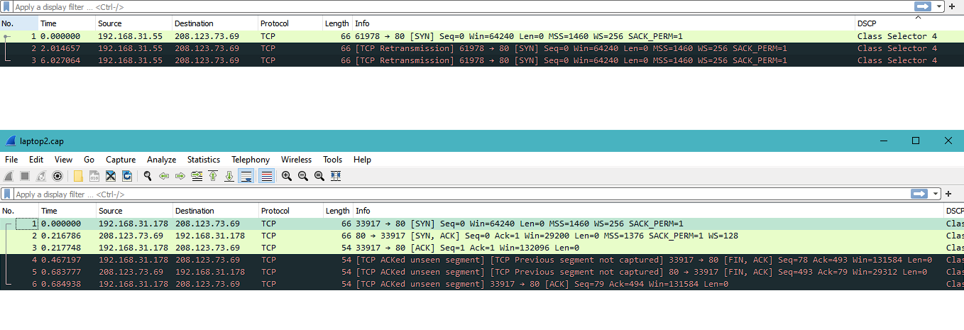

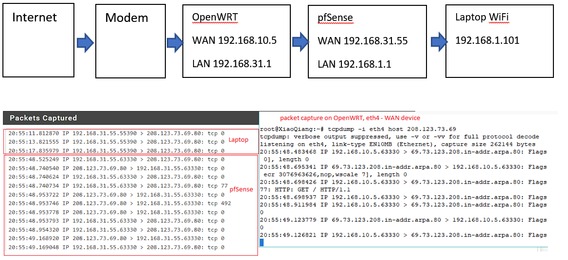

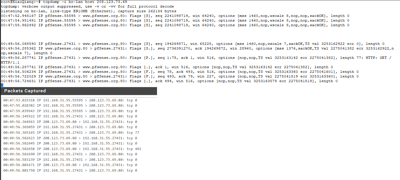

                                        @rcoleman-netgate I tried this scenario to get packets from OpenWRT. I ran curl on my laptop first then pfsense box
                                        pfSense WAN captured packets from both of them but didn't forward requests from my laptop to OpenWRT. We can see OpenWRT captured packets after 20:55:48 only. Do you know why pfSense WAN didn't forward packets from my laptop?
                                          It's not that pfSense is not forwarding the responses it's that it never gets any responses to forward. For some reason.
                                          There must be some difference between the packets from the client and those from pfSense. The TTL would be different for example.
                                          The pcap on openwrt doesn't show any of the traffic from the laptop behind pfSense. Was is started after that had failed?
                                            My number one suspect here would be the USB NIC you're using except you have that as LAN and it appears to be passing inbound there.
                                            What is the WAN NIC in that device? What hardware off-loading do you have enabled?
