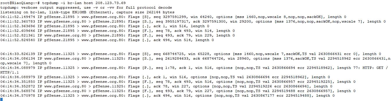

      I tested again and this time I captured OpenWRT LAN interface. pfSense WAN directly connected to OpenWRT LAN.
      Traffics forwarded from my laptop don't have TS val, but from pfSense have.

        Ok so pfSense is sending that traffic as expected and OpenWRT sees it on the LAN but no replies.
        Are there any replies on the OpenWRT WAN?
        You're probably going to need to open that in Wireshark and look at it more closely.
        You might also connect the laptop to OpenWRT directly and pcap the same traffic there when it succeeds.

          This is the packets capture result on OpenWRT LAN interface
          Top = my laptop => pfSense => OpenWRT (unable to connect to internet, no reply from OpenWRT WAN)
          Bottom = my laptop => OpenWRT (able to connect to internet)
            OK, it looks like you may have some asymmetric routing somewhere.
            In the working pcap you can see there is traffic in that TCP session that did not pass the interface.
            By far the most likely is that the laptop you're testing from has some other connection. Like maybe it has wifi directly to the ISP "modem".
            pfSense will block out of state TCP traffic like that. Lesser firewalls may not. ๐Ÿ˜‰
            Do you see any blocked TCP traffic in the pfSense firewall log?
            It's still hard to see how that could happen though because each device is source NATing on the way out...
            But that fact the ping works also points to that.
