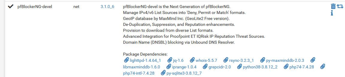

                      johnpoz LAYER 8 Global Moderator @garyn
                      @garyn said in rules error:
                      I have 3.1.0_5 installed
                      But isn't _6 available - that is what I have installed on 22.05..
