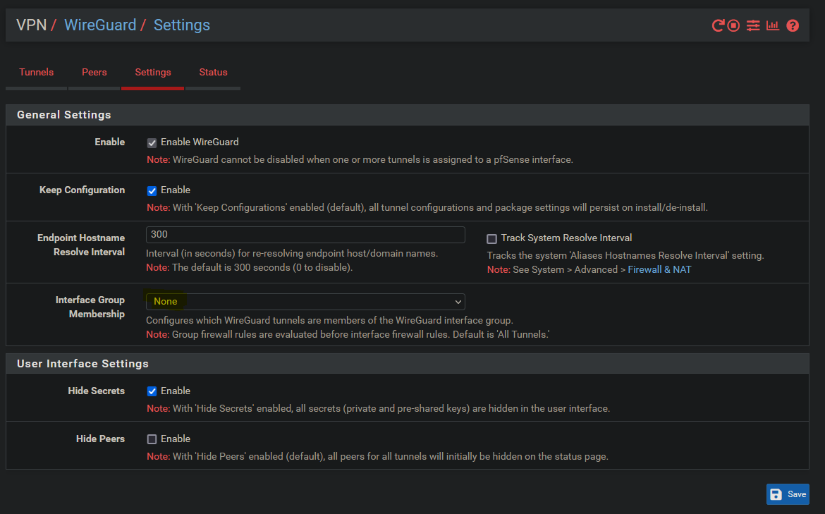

                    • Bob.DigB Offline
                      Bob.Dig LAYER 8 @stephenw10
                      @stephenw10 said in Routing Wireguard Clients via VPN Gateway.:
                      and, yes, all Wireguard tunnels are always a member of that.
                      Wait a minute...
                        Huh, interesting I missed that. 👍
