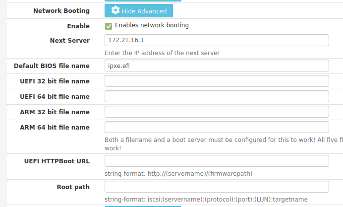

            Hmm, well pfSense does have the ability to send different boot files for different client types so you may be able to do that:
            Otherwise you would need to arrange some sort of override for the auto-generated conf file. I thought there might be something build in for that, like there is for mpd.conf, but I cant see anything.
