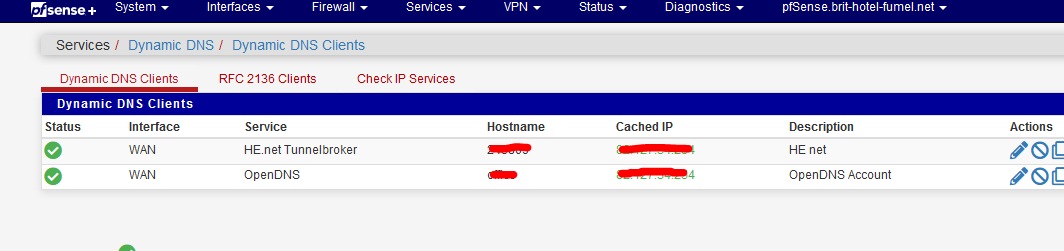

        You mean, showing this page :
        doesn't work 'well' / slows down / aborts ?

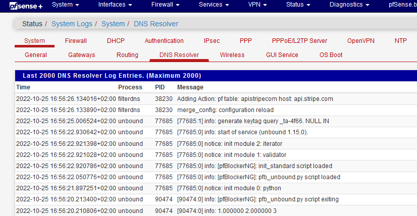

        Go to the DNS Resolver log, here :
        and look (count) lines that look like this :
        Now, count the lines that contain
        start of service (unbound
        Type Ctrl-F, enter that string and count them.
        You can also see how long it takes for unbound to 'stop' and 'start'.
        Add to this knowledge : the time it shuts down, and starts, your DNS on your network (and for pfSense itself) doesn't answer ...
        Knowing all this : it might be a good thing to take measures so that unbound is restarted less often ;)

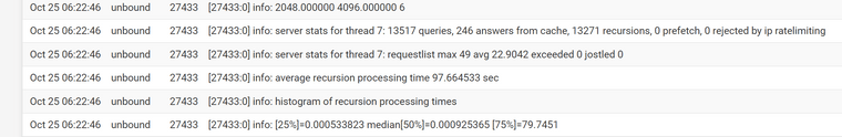

          @gertjan there was a DNS issue because the average dns resolution was 97s
          and yes, I could not open the Dynamic DNS page. the page will not open

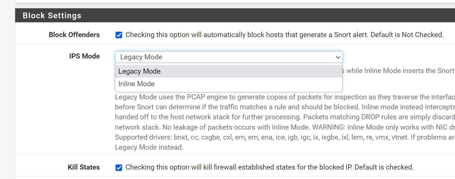

            @gertjan this was probably part of the reason I had so much trouble. I setup Inline blocking mode in Snort interface settings. Since I reverted that, things seem to work fine again. Almost 18hr without interruption.

              Wait ....
              Because snort has nothing to do on the 'hot' side (WAN) as all traffic is already blocked in the first place, it decided to focus on your side (LAN) and makes your live miserable by blocking traffic from the firewall itself ??
              What was the reason you installed snort in the first place ? To do what ?
              But ok, you made a good choice : remove (snort) as much non essential stuff on your firewall : things work way better, less maintenance, less can go wrong. Use only what you can manage 👍
