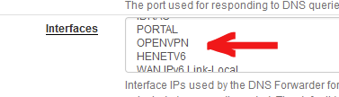

        Bt adding the OpenVPN server interface into this list :
        so dnsmasq listens also on that interface for DNS requests.

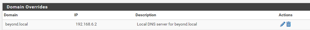

          to make this work, i have enabled the dns forwarder on pfsense, with domain override:
          so for whatever host on the local domain, the dns server on 192.168.6.2 is able to return the IP succesfully.

          I have checked the screenshot of you, but something is not right, the interface OpenVPN (for remote users) that exists under firewall, does not exists on the DNS interfaces menu.

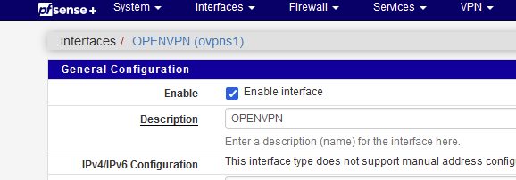

            Go to Interfaces > Interface Assignments, after the "Available network ports: ", then pull down the interface list, select what is probably named "ovpns1" (from OpenVPN Server 1).
            and then Add a new interface (green button).
            Then rename it to something more useful : I've chosen OPENVPN (that wasn't the smartest choice) :
            Now you have a new interface.
            Populate it with firewall rules as empty == block all.
            This newly created interface can be used by unbound, the forwarder, etc.

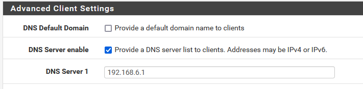

              I get the DNS working for remote clients by pushing a DNS server the IP of pfsense. Assuming that the firewall can perform the forwarding succesfully, remote users have a routing to LAN, but not DNS or internet gateway. (We have used VPN only for remote access to servers).
              So under advanced client settings in Open VPN Server configuration, i just push a DNS server, the pfsense address, like below:
              Simple thing but i didn't knew that , because i never needed that until today.
