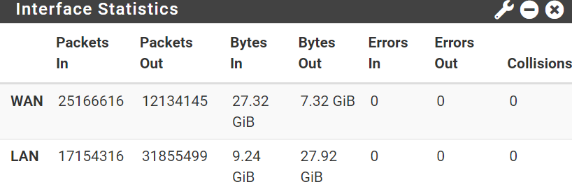

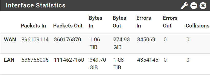

      Any Ideas on troubleshooting this? Strangely I have multiple inbound, but zero outbound.
      They increment continually.
      Both of these are on an dual port intel 10gig card. ix0/ix1

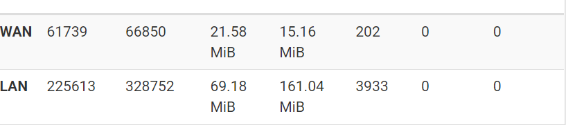

                I re-booted in-between the two posts to disable hardware checksum offload.
                Mine are infact all checksum errors.
                I included the first screenshot to show the numbers are not insignificant. Or perhaps they are and they are "normal" and I can ignore these. I know that before I upgraded the NIC to support this new ISP service I had very few errors, often none when I checked.

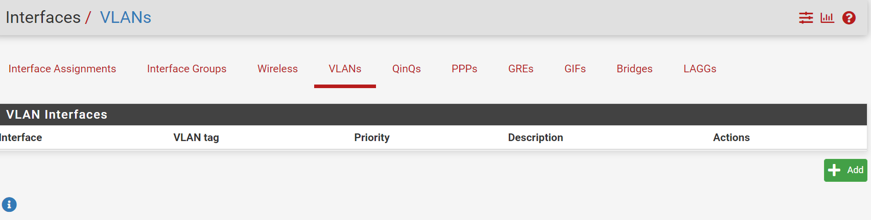

                      Hmm well you have VLAN_HWCSUM enabled there. Do you have VLANs on those NICs?
                        mervincm @stephenw10
                        Nope
