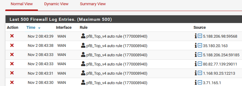

      Issue:
      Time and date stamps in Status/System/ Logs/Firewall/Normal View do not reflect the current time and date. Screenshot 2022-11-01 234948.png

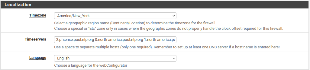

      You can see the time settings here:

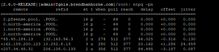

      You can see the results of ntpq -pn here:

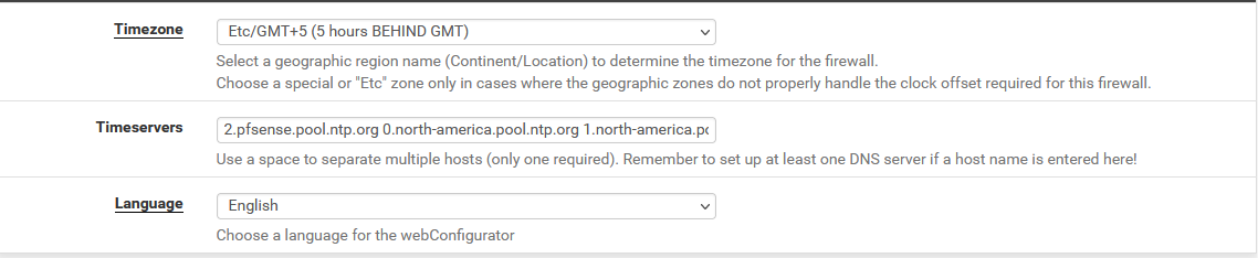

                            [2.6.0-RELEASE][admin@Ignis.brendhanhorne.com]/root: date
                            Thu Nov  3 13:38:02 -05 2022
                            I have done that as suggested. I will let it run for a bit and see what the logs say. I thank you again for your help. It will be interesting because I am technically gmt -5 and I may have to do another restart. Which I will do later tonight.
