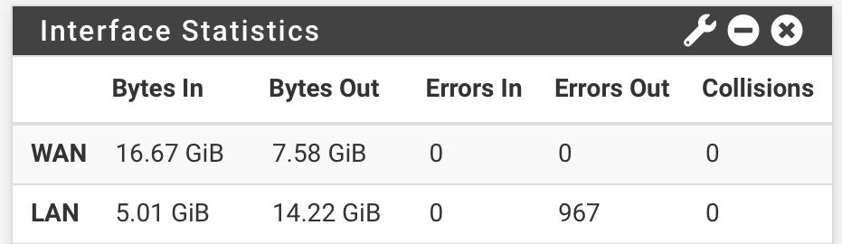

Here is the issue: I see "errors out" increasing on pfsense LAN interface when I run iperf3 between pfsense and each host.
I tried running between pfsense <-> ubuntu host (errors out increases)
I tried running between pfsense <-> truenas host (errors out increases)
I tried running between pfsense <-> freebsd host (errors out increases)I tried running between truenas <-> freebsd host (no errors out)
I tried running between truenas <-> ubuntu host (no errors out)Proxmox is version 7.2-3. Kernel version is 5.15.30-2-pve.

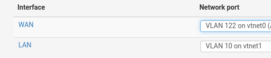

below is ifconfig output. vtnet0 is WAN, vtnet1 is LAN. My WAN and LAN both use vlans btw.
vtnet0: flags=8843<UP,BROADCAST,RUNNING,SIMPLEX,MULTICAST> metric 0 mtu 1500
options=900b8<VLAN_MTU,VLAN_HWTAGGING,JUMBO_MTU,VLAN_HWCSUM,VLAN_HWFILTER,LINKSTATE>vtnet1: flags=8843<UP,BROADCAST,RUNNING,SIMPLEX,MULTICAST> metric 0 mtu 1500 options=900b8<VLAN_MTU,VLAN_HWTAGGING,JUMBO_MTU,VLAN_HWCSUM,VLAN_HWFILTER,LINKSTATE>

Right now, error count is at 967 (i had to restart my machine). here is sysctl:

Hmm, nothing shown there...
Are you seeing that only on vtnet1?
Are you actually seeing connection dropped when the error rate is increasing?
Ah, that looks like LAN is actually vtnet0. Can we see the sysctl output for that?
nope LAN is on vtnet1.

Hmm, interesting the in/out bytes in your screenshot for WAN lined up exactly with the sysctl output for vtnet1. Just coincidence perhaps? Were those takes at approximately the same time?
You still haven't said if you're actually seeing connections drop when you see those errors?
@stephenw10 They were taken at different times. It must have been a coincidence.
How would I know which connections have dropped? Tcps auto retry anyway. Only weirdness i feel i have is my dns queries sometimes don’t resolve intermittently.
Ah, OK do you see anything in the sysctls that looks like the same error count shown in the interface status?
