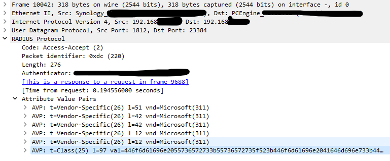

      since the last update on my Synology Nas I'm no longer able to login to my PFSense using my domain account.
      I can see that the class attributes are set (using Wireshark) but the PFSense told me that there are no class attribute is set.
      Is there a way to debug that function in PFSense to see where the problem is? (I don't see any problems in the logs from PFSense)
      Or maybe this is the wrong subtree in this forum and someone can help me where I can ask for help. Thx for you help.
      Cheers
      Marco

            MarcO42
            Hi Andy,
            many thx. I can try this.
            Please don't missunderstand me. I managed it to work in the past and my class string look like:
            Domain Users;Users_R;Domain Admins;Denied RODC Password Replication Group;Users_RW;PfSenseGroup
            and I had added PfSenseGroup to PFSense.
            After the last update of my Synology I can see that same class string in the radius response but the PFSense show that the asuthentication works but don't show goups.
            Strange thing is that I didn't see any parsing error or any other authentacing error in the logs of the PFSense.
            Cheers
            Marco

                  MarcO42
                  Ok, I can see that the class attribute is there...like in wireshark....but do you have any idea how I can figure out why PFSense don't show them when I try to test it with
                  Diagnostics -> Authentication
                  There I only see that
                  User xxx authenticated successfully. This user is a member of groups:
                  and the group resonse is empty.
                  Somthing must fail on PFSense side...but nothing is in the logs.
                    MarcO42
                    Ok, just found that there is a function in: /src/etc/inc/auth.inc
                    that called
                    function radius_get_groups($attributes) witch handled the attributes.
                    Here is the code:
                    function radius_get_groups($attributes) {
                    	$groups = array();
                    	if (!empty($attributes) && is_array($attributes) && (!empty($attributes['class']) || !empty($attributes['class_int']))) {
                    		/* Some RADIUS servers return multiple class attributes, so check them all. */
                    		$groups = array();
                    		if (!empty($attributes['class']) && is_array($attributes['class'])) {
                    			foreach ($attributes['class'] as $class) {
                    				$groups = array_unique(array_merge($groups, explode(";", $class)));
                    		foreach ($groups as & $grp) {
                    			$grp = trim($grp);
                    			if (strtolower(substr($grp, 0, 3)) == "ou=") {
                    				$grp = substr($grp, 3);
                    	return $groups;
                    I would like to debug this one and log all attributes like this
                    foreach ($attributes as $att) {
                    	log_auth(sprintf(gettext('Attribute: '), $att));
                    But this shows me only this:
                    Nov 3 16:35:45 router php-fpm[5433]: /diag_authentication.php: Attribute:
                    So maybe someone can help me with this, please?
                    Btw. I'm sure that there are attributes:
                    Cheers
                    Marco
                      MarcO42
                      Ok, found the problem. Synology is now sending the Groupe name in CamelCase.
                      In the past the Groupe name was lowercase and the check in PFSense is case sensitive.
                      Cheers
                      Marco
