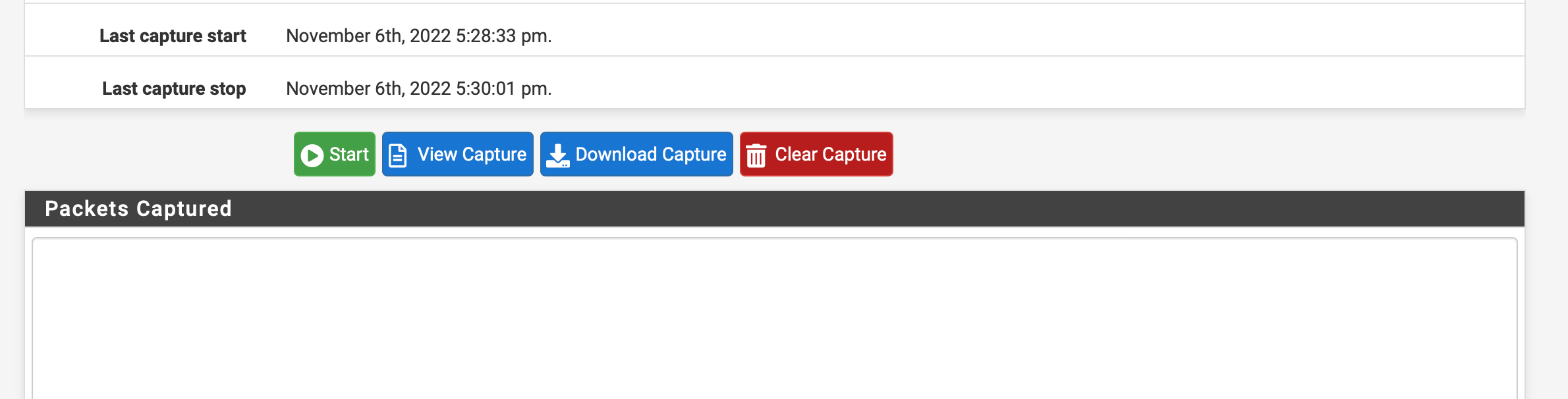

Here is the result of the packet capture running for about 90 s, while my iPhone was trying to get onto the newly set-up VLAN ID 13 WiFi network:
Nothing! Let me think about what that implies.

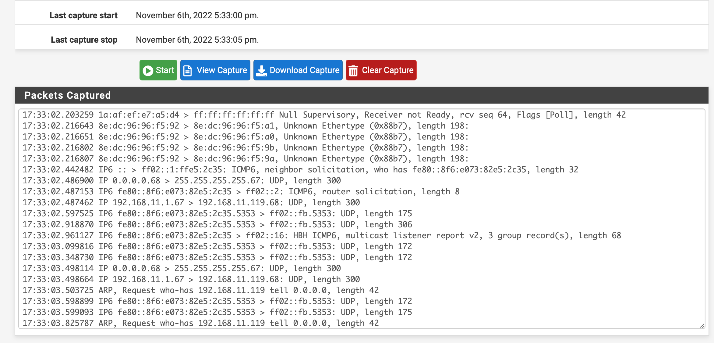

Here is a packet capture with my phone getting onto the VLAN ID 11 WiFi network (successfully):
So, evidently, devices trying to get onto VLAN ID 13 don’t get an IP address, because their DHCP request never gets to the pfSense appliance.
@dominikhoffmann What's running at 11.1?
this implies the request comes in (UDP port 68) and a response goes out.
I would run the capture on the VLAN on port UDP 68 and nothing else... just sniff the traffic. The extra stuff showing up is unhelpful.
Well, that's from the VLAN that’s working. The same packet capture running on the VLAN that is not is just crickets.

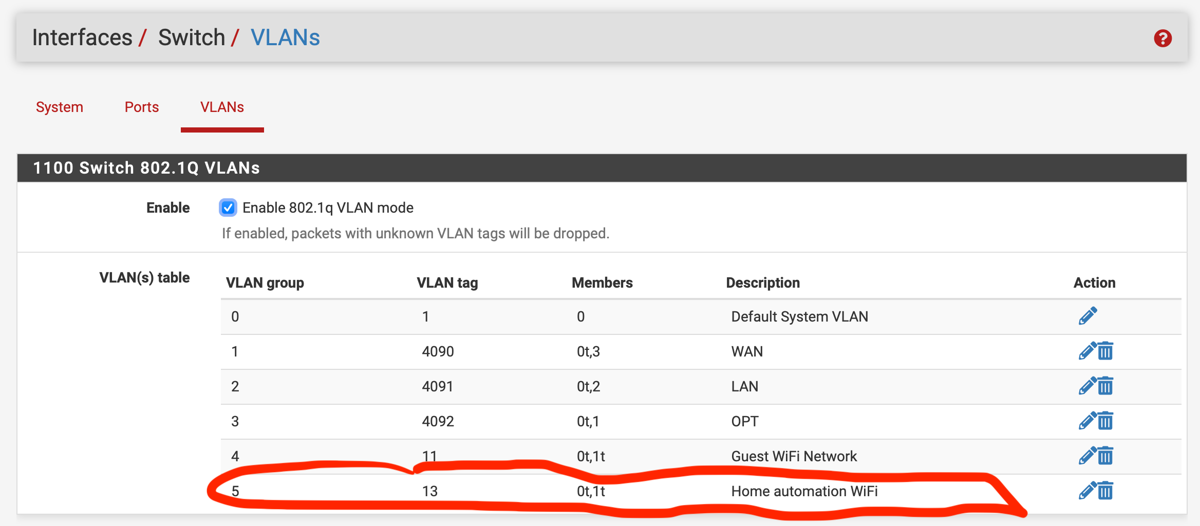

What is the Interfaces->Switches Ports and VLAN tabs like?
You have a device with a built-in switch, you have VLANs not communicating, I don't see any screenshots of the actually Netgate's 1) Model number and 2) built-in switch programming.
Here are the pages on my 7100:

@dominikhoffmann Please check out my request above for your Netgate firewall switch screen shots like what I provided...
That’s the answer:
I just added that last VLAN group. I knew, that I had forgotten something!
Hurray! Success!
Thanks so much, Ryan!
