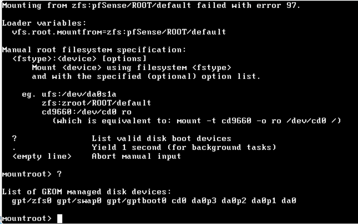

      pfSense 2.6 won't boot after power failure and drops into mountroot> prompt. What to do?

      • stephenw10S
        Do you have any BE snapshots you can try rolling back to at the loader prompt?
        Otherwise the most common reason I've seen that on a ZFS install is that the required zfs modules are not being loaded.
        At the the loader prompt (not the mountroot prompt) try running:
        load /boot/kernel/kernel
        load /boot/kernel/opensolaris.ko
        load /boot/kernel/zfs.ko
        boot

        • G
          gjaltemba
          Thank you for your help with my pfSense boot error 95.
          Not sure how to get to loader prompt. My recovery strategy is to re-install and reconfigure WAN, LAN and OpenVPN.
          Will keep working on this problem as a learning exercise.

          • stephenw10S
            Reinstaling and restoring your config will probably be quickest and safest.
