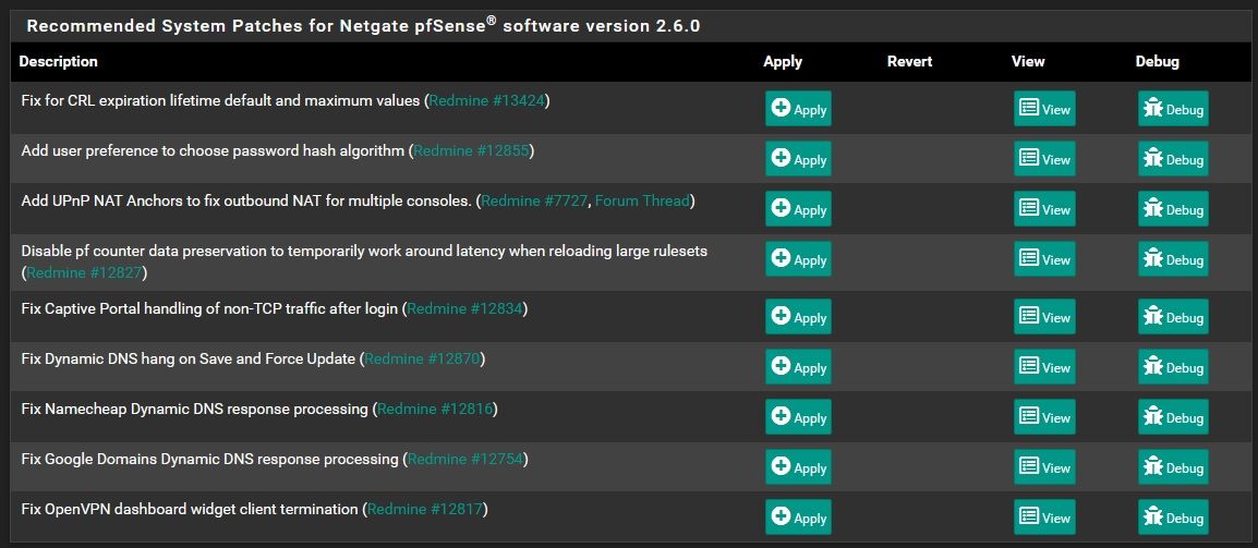

              • K Offline
                Kilted1 @SteveITS
                @steveits
                HA! I found it!
                And I see the "Add UPnP..." patch.
                Given that you had also helped me with the other post I had made about by-passing my VPN for certain traffic, is that the only patch that would be good for me to install?
                The pic is the list that showed up of patches.
                Dale

                      Applying the recommended patches should be fine. All of them have been tested to work. However most of them won't do anything unless your particular setup is hitting the issue they solve.
                      I would apply the UPnP patch and the disable pf counter patch and leave the others unless you know you need them.

                                          Previously I had made a firewall alias for BOTH my PS3 and my son's and used it in the rule attempts. And I can go to the UPnP status and see that right now (they are turned off right now) that each of them have udp ports assigned to them (son's has one and mine has two) with the description of "DemonwarePortMapping.
                                          I don't remember when I had done it but, if you scroll back up this post to the picture of the available "Pathces", I have actually applied all of the except the top two.
                                          Maybe one of those worked?
