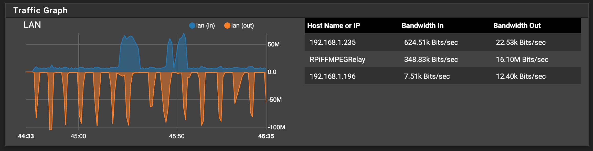

      Status: Traffic Graph does not show any traffic that would be saturating either the tunnel or untunneled traffic out to the internet:
      https://www.kan.org/pictures/TrafficGraph.png

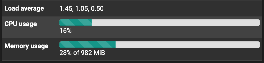

      I did not think to log the CPU or RAM utilization when the tunnel was misbehaving, but here it is on the SG-1100 side after IPSec restart:
      https://www.kan.org/pictures/CPURAM.png
