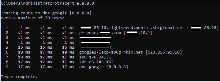

      Then here comes the thing that keep me wondering for a week now:
      1. When I do traceroute going to internet let say 8.8.8.8
        I noticed that each private IP (let say the first hop) like the gateway IP (which in this case the vlan interface of the coreSW) has domain name with this format
        "<IP>.lightspeed.moblal.sbcglobal.net"
        and when I do network scan, all devices hostname show this format
      2. Run some network inventory like runzero and it tag this domain with type RDNS which is base on research is a PTR or reverse dns thing
      My questions are:
      1. how to disable it? or this is normal behavior of pfsense upon using dns forwarder service?
      2. Which reverse lookup zone pfsense is using to tag my private IPs with this domain
        'lightspeed.moblal.sbcglobal.net' that not even our domain name
      3. OR this domain is from public DNS that I put under system>general setup>DNS Server Settings?
      Appreciate the help or any feedback from pfsense guru here in this forum

          maelove.am @Gertjan
          @gertjan hello, first thank you for your comments
          1. When I use dns resolver service before, I can't get it to work that's why I tried testing the dns forwarder instead.
            What I did before on dns resolver was >> enabled it>>enable port forwarding option>>put public dns on general setup>dns setting
            then on the client side, since I have my dhcp configured on the core switch, dhcp setup was to use firewall IP as DNS but I dunno what I'm missing here coz i doesn't work
          2. yes your right, dhcp was configured on my coreSW, then default route to pfsense
          then
          1. this is my traceroute (executed on the client and from pfsense)
          there you can see that the private IP within my VLAN86 has this domain..I can't figure out where the hell that domain came from
          I run it on the test server that is directly connected to coreSW
          there you can see reverse lookup also works where 86.10 is the gw ip of vlan86
          my dns was 10.1 (pfsense lan ip)
          and the domain for that IP for me is unknown.. I can't remember I did configure such domain
          Do you think it's something on my dhcp setup on the coreSW?
          1. this is my system>general setup
          Yes, I haven't set this domain as network name for local devices
          I don't have network name. this is what I configured so far on the coreSW for the DHCP
          you can see there, I tested it to relay to another dhcp server 86.253 (test AD - xxx.local) then on the AD I put the 10.1 (pfsense) under dns forwarder
          then when client obtain IP (see ipconfig /all) 86.254 (test client)
          and run traceroute
          you can see from the traceroute that the domain I put as PTR record works also, this for sure
          i know this domain since I add it on the AD dns service as PTR records pointing my ip 86.10 to that domain
          and do nslookup for 86.10 it gives me same domain
          now going back to scenario where my dhcp server dns was set directly to pfsense, I can't figure out where this domain (lightspeed.moblal.sbcglobal.net) is coming from
          any idea, what else I need to look for?
          I just want to figured out where that domain is coming from.

                  maelove.am @Gertjan
                  @gertjan hello there
                  Yeah, I'm puzzled too. I just can't prove if its from our huawei core switch or from pfsense itself.
                  But I don't see any documentation regarding huawei having that domain.. I already escalate it to huawei TAC and they just said this "if 172.1.83.10 is the address of HW switch, switch just replay a icmp packet, will not take these information (lightspeed.moblal.sbcglobal.net), and it is the behavior of PC."
                  and base from this forum, I think no-one yet encountered this ghost domain with their pfsense, so I think its not really the pfsense causing
