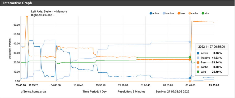

      hi everyone,
      I looked at other postings and cannot find the answer here. I have a brand new NetGate 4100 for a small home office. 4G of RAM and 16G of SSD. everything is out of the box and standard install. I have not done anything special to the box. the volume of the traffic is minimal and I run about 4Mbps of traffic on the high end. I have clamav, netBlocker, and Suricata running on the box, all with standard configs. And yet, I am running into multiple issues.
      My Clam AV dies every few days with an out of swap space error.
      Nov 27 07:00:14 php 39596 [pfBlockerNG] No changes to Firewall rules, skipping Filter Reload
      Nov 27 07:00:00 php 39596 [pfBlockerNG] Starting cron process.
      Nov 27 06:43:51 kernel pid 46661 (clamd), jid 0, uid 106, was killed: out of swap space
      Nov 27 06:00:17 php 79080 [pfBlockerNG] No changes to Firewall rules, skipping Filter Reload
      Nov 27 06:00:00 php 79080 [pfBlockerNG] Starting cron process.
      when I look at the memory usage around this time, the free memory is around 23% and after the crash it shoots up to 63%. But at no time it gets close to 0 that will even require using swap space.
      looking at the clamAV logs everything looks normal at around this time.

      note that last update for both files were at 6:43, at the time of crash.
      I have read other posting here about the out of swap space issues, but can't find anything that actually points to a solution.
      with this being an out of the box issue at such a low traffic load, adding all the issues that I am having with Suricata, I am wondering if this was the right purchase. there seems to be a lot of issues here but admittedly I am new to PfSense. thought I give this forum a try first.
      thanks for any help.

                    Here though you are exhausting the RAM so running from an SSD would not help directly. You still should run from SSD of course.
                    You would need to tun those packages more carefully to run them all. 4GB should be enough though unless you have chosen to load all the lists/signatures.
                    • K Offline
                      knight2f6 @stephenw10
                      @stephenw10 thanks. I am actually running the bare minimal set of signatures. In the case of Suricata, I am only running the Fedora and nothing else. I have tried multiple configurations with same result. for most part on each package I only enabled the bare minimum settings. The memory never hits the 100%, it barely touches 80% before ClamAv crashes. See the original image.
                      I guess what I am not sure is how the system claims to run out of SWAP space if it still has 20% of free RAM. Unless of course, it runs out of the memory AND swap space in the 5 minutes interval that is between each sampling period for the graph. Although, I have looked at this graph multiple times during each crash and they all look the same. You would think out of the 12 or so crashes, one of them would show memory going down to 0.
                        Try running top -HaSP and the command line and see what's using memory.
