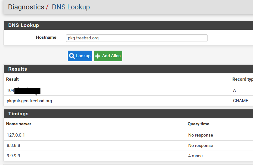

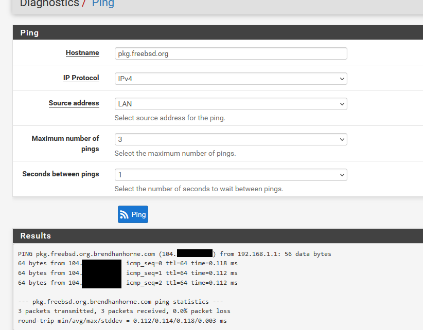

      So yesterday there appears to have been a dns issue with pkg.freebsd.org. It has since been resolved.
      But now it seems like the firewall is mad and won't go back to normal.
      If I try to ping pkg.freebsd.org it comes back to host unkown or if I try dns lookup it comes back with my server ip.
      How do I get the firewall to stop sending requests to get pkg.freebsd.org to the abyss.

        Tried doing a dns flush, still having the same issue
        • stephenw10S Online
          Well you are seeing no response from anything except 9.9.9.9. So anything cached is going to be there.
          What do you expect that to resolve to? Are other devices resolving it correctly?

              johnpoz LAYER 8 Global Moderator @Understudy
              @understudy said in pfsense dns cache? ping sends me to my server:
              You understand you have a wildcard setup on your public dns right??
              I can go to anything.yourdomain and get back that IP
              ;; QUESTION SECTION:
              ;lsjflsjdsf.brendhanhorne.com.  IN      A
              ;; ANSWER SECTION:
              lsjflsjdsf.brendhanhorne.com. 86400 IN  A       104.x.x.x
              Not sure what that has to do with some issue freebsd dns was having?
                  @understudy I don't normally post public IPs - but you were pretty open about it - just let me know if you would like me to remove the public IP from this thread.
                  That wildcard explains what you were seeing. Not a good idea to use the same public domain as your local, especially your going to have your clients use a search suffix with that domain, etc.
                  I would use say yourdomain.lan for local - or just use the new home.arpa domain, etc.
