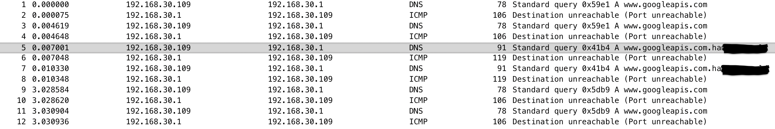

I recently purchased an android device which provides a digital calendar and clock.After successfully connecting to WIFI I noticed the device would not update its location nor connect to any external services. I kept getting an error that it was unable to connect to the manufacture's server.
I performed a wireshark packet capture and I noticed the following:
Its performing DNS lookups with attaching the local domain to the end. I use the local domain for remote administration of my PFSENSE/SSL etc.

@posix pretty much any os does this, this is suffix search.. Why you can not get there is there is no answer.
Look at your sniff where is the answer to your queries. 192.168.30.1 is sending back a reject, that icmp port unreachable..
example - here is my windows machine.. see it asks for www.googleapis.com with .local.lan added at first because this is my local search domain.

Your laptop is asking a different IP
Server: 192.168.53.11
Address: 192.168.53.11#53Your sniff is asking 192.168.30.1 and he responds with sorry buddy your not getting there.. What rules do you have on this 30.1 interface in pfsense?

You are right, this android device joined the IOT SSID. On pfsense I have majority of IOT devices static DHCP binding with DNS assigned. But for dynamic DHCP pool I did not specify DNS server. So it was using .30.1 (pfsense gateway) as DNS and I have DNS redirect configured for external DNS servers not pfsense itself. This is resolved.
Thank you very much for pointing out the issue.
