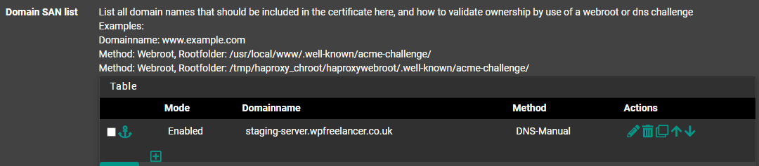

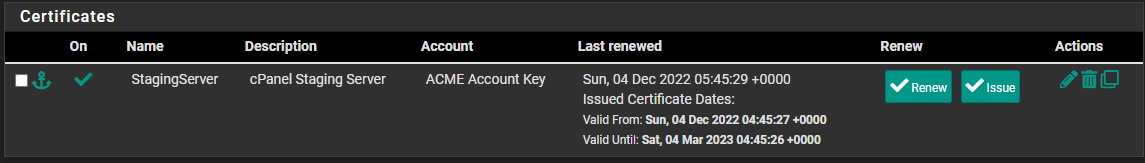

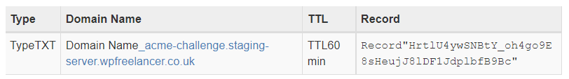

      1.) Create a ACME Certificate which is issued
      The domain is registered with google domains, so for this certificate, I'm using the method of 'DNS-Manual' as its authentication method.
      On creation of the certificate, I was instructed to put a TXT record on the DNS record for the domain, which I have done below and it's propagated
      https://mxtoolbox.com/SuperTool.aspx?action=txt%3a_acme-challenge.staging-server.wpfreelancer.co.uk&run=toolpage

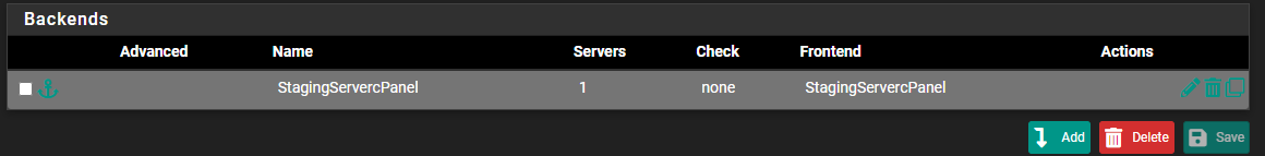

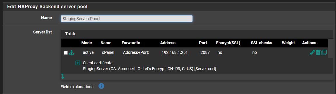

      2.) Created the HAProxy backend
      The Backend config I have selected the ACME certificate created in step one

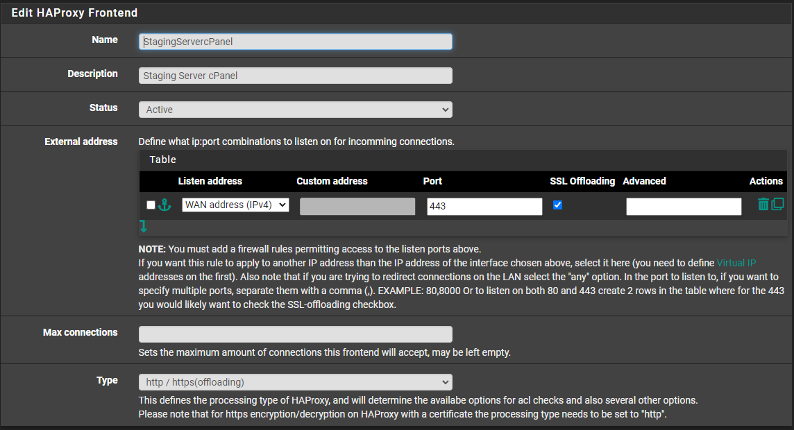

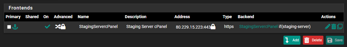

      3.) Defined the HAProxy frontend
      The frontend is using SSL offloading
      Here are the ACL and actions

        The client certificate might not be, what you need. This is meant for authenticating the client on the server.
        You have to assign the certificate to the frontend.
